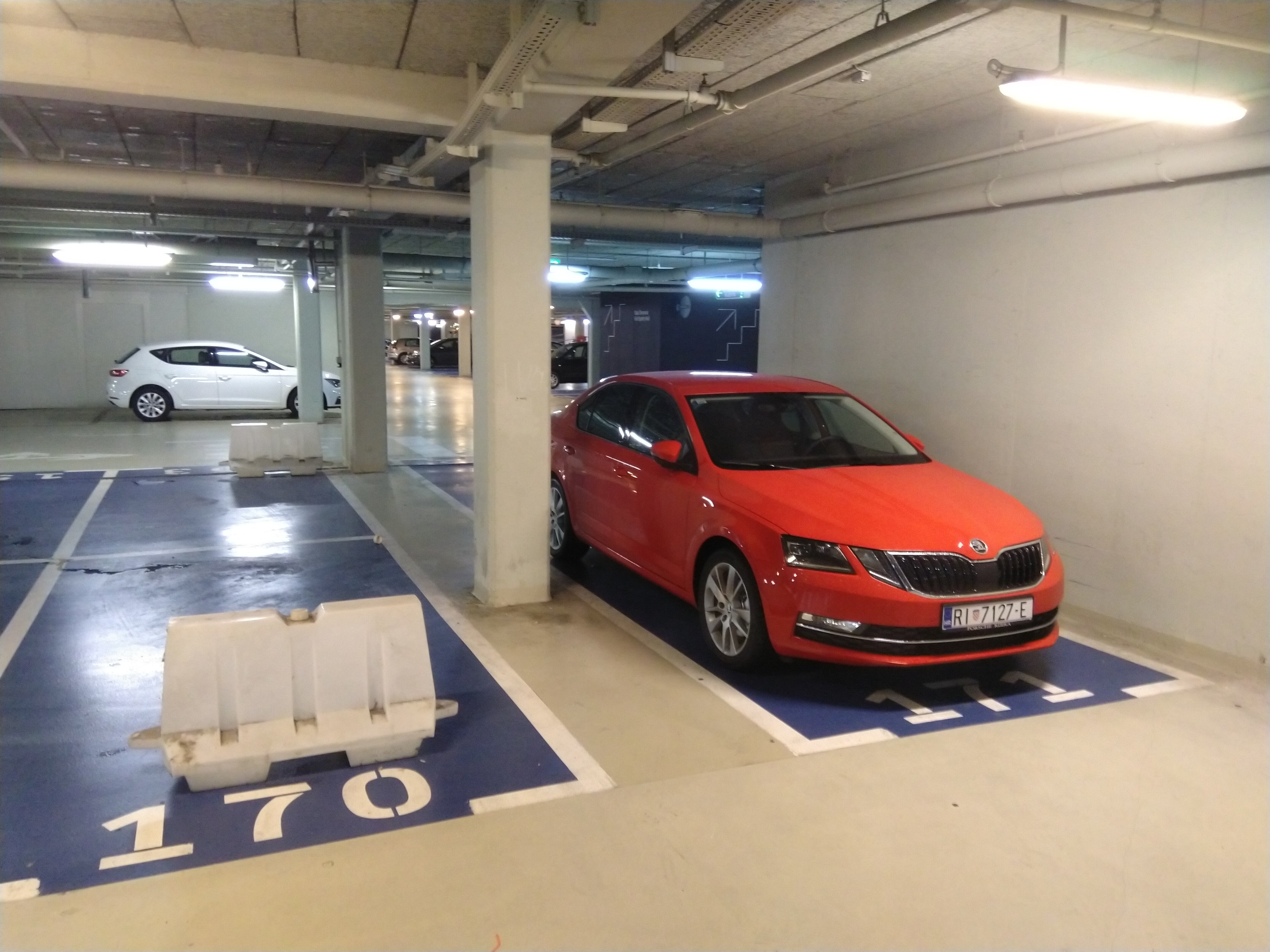

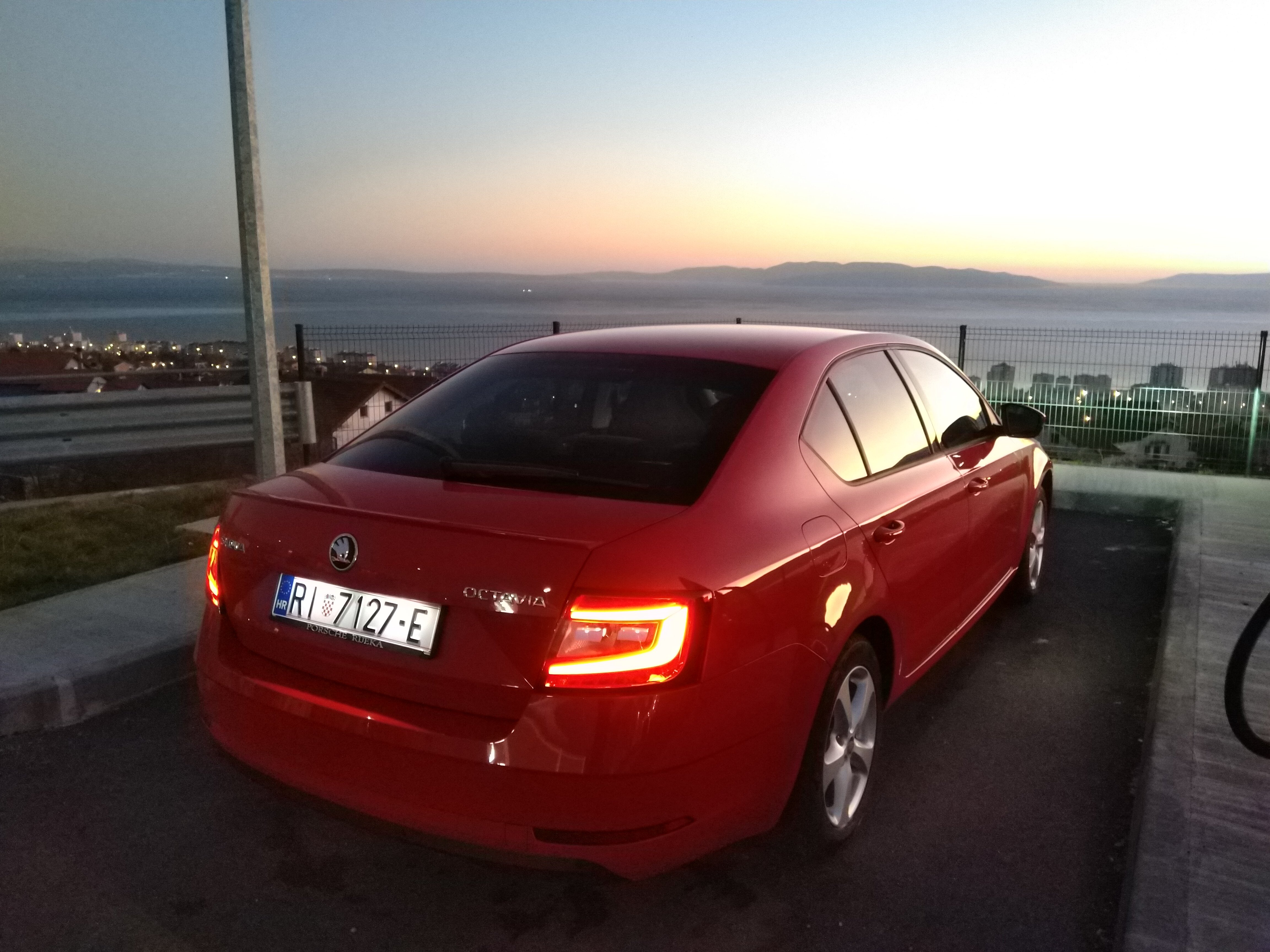

Here is my Octavia 1.5 TSI (yes with the "kangarooing" problems)

A warm welcome to the forum !  I have the same type of car and I believe the problem is caused by the anti stall system wanting to help you pull away.  I find,  let it do its job, which is to increase the revs as you let the clutch out.  You will hear the engine speed increase without you touching the accelerator.  The alternative is to use more revs than usual as you pull away.  Have a look at the Octavia posts.  Great pics:thumbup:
