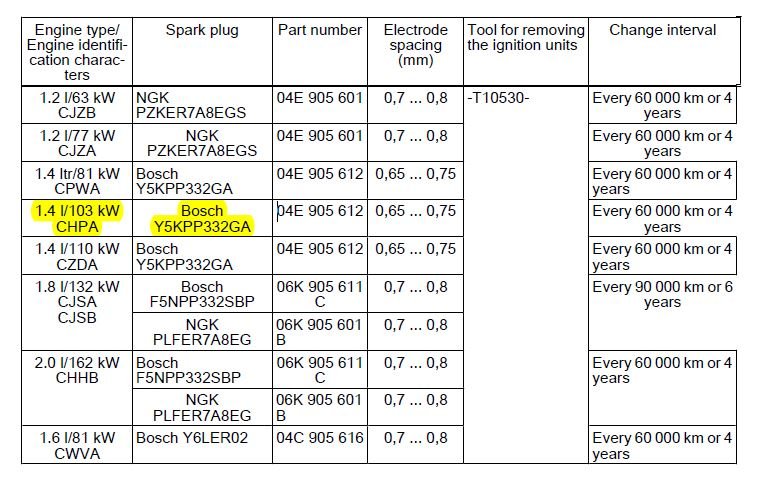

@zahaby
From the Maintenance Manual Skoda Octavia / 10.2014:
Thanks very much
