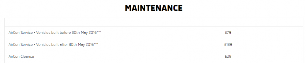

See this video from Skoda UK, very informative, and backs-up what has been posted earlier about fully removing, measuring and replenshing the gas...
https://www.skoda.co.uk/owners/servicing-maintenance-fixed-price
Sounds like they're offering you the 'AirCon Cleanse'.
Until you ask them, I imagine it'll be one of these, essentially an aerosol can discharged into the cars interior with the engine/air conditioning turned on, or a simple squirt into the vents. I've tried both on an old Octavia with smelly air conditioning, all they did was temporarily mask the smell, it soon returned...
