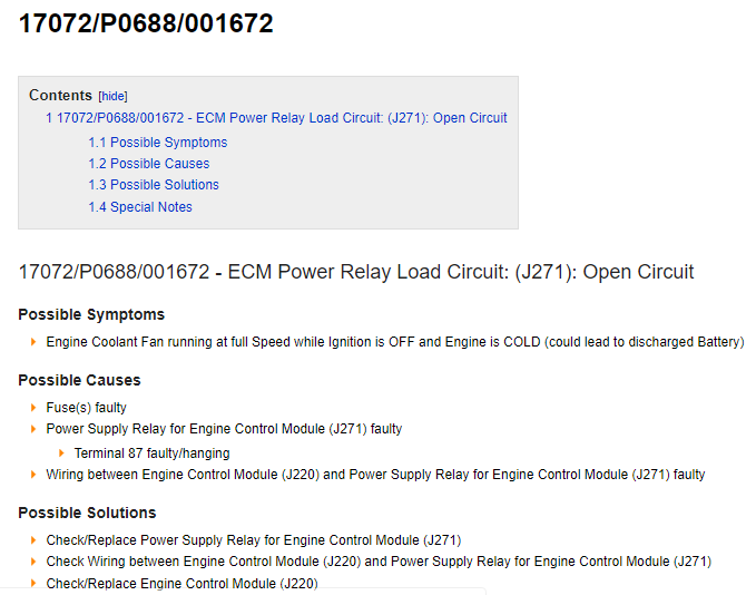

I have fault code p 0688 p2249 I also had when 1st done it 2149 and 2146
Thank you I am abit of an  amateur but I will look for these fuses and check them , I just hope it’s not the ecu , Skoda told me 2k !! I ant got that sort of money :(
P2249 was p2149
I had a fault with it before hand it wasn’t starting I changed the relay 644 and it worked from 13 faults to 0  and started abit rough at first but then felt fine ...left it for 2-3 days went to pick it up and nothing at first I fort the battery had died but got that tested it was good ,  so now I don’t know really where to start , I’m guess fuses then injections , then wires but how do I check each wire , I pulled the ecu it was in the car via a tie wrap open to all the elements, it’s looked ok just a few white spots , the last owner said the ecu was tested but they couldn’t find a fault , it’s a nightmare
