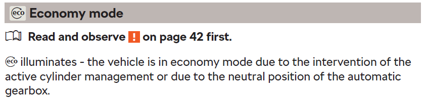

The Cylinder deactivation text message is shown only on the fuel consumption pages. On other pages it shows a small ECO in a circle symbol towards the bottom right on my Superb.

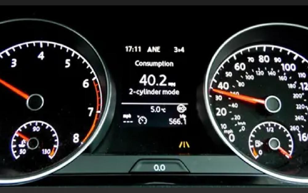

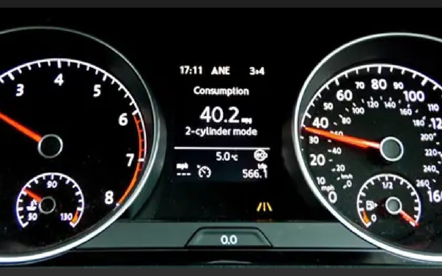

ACT is available all the time subject to the rpm and power demand limits I mentioned before. If you run in ECO drive mode with a DSG, when you lift off the throttle, the DSG will go into coast mode, the clutches lift off and so the engine is disconnected and the revs drop to idle, ACT will deactivate on that scenario because the revs are too low. However ACT will still go into 2 cylinder mode whenever light driving conditions that meet the rpm/power conditions allow.
The "2-cylinder mode" message is only displayed when you select the fuel consumption pages, it does not appear on other pages because there simply isn't room or it would detract from other messages. I addition there is an ECO in a circle symbol that appears on all pages AFAIK whenever ACT is active. Here is what it looks like, take note of the ECO symbol position ....

Went out again and tested again. The '2 cylinder' message appeared, as XMAN said, when the 'CONSUMPTION' screen was displayed!!
