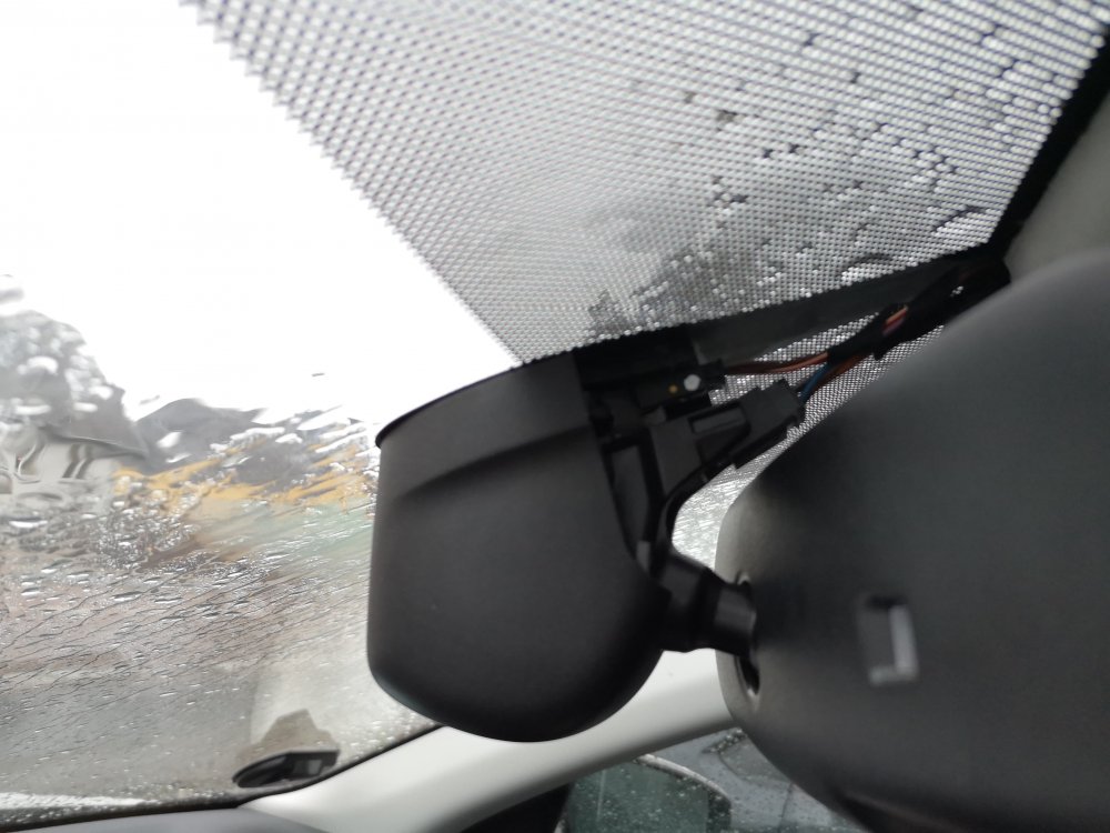

Hi.
Im trying to get my rainsensor out to inspect if the gel pad is defect.
But im not sure how to get the last cover of my mirror, its the part thta covers the FLA/HBA camera/sensor.
Can somebody help me, how do i get this of without breaking stuff?
Thanks Christian
54516553_2177051829037726_2760292914687901696_n.thumb.jpg.4ef9bcb20dd4a8a807f1eb2455f8a7e3.jpg
It is necessary to disconnect the mirror connector and turn the mirror support counterclockwise on the glass, the front cover does not need to be removed
