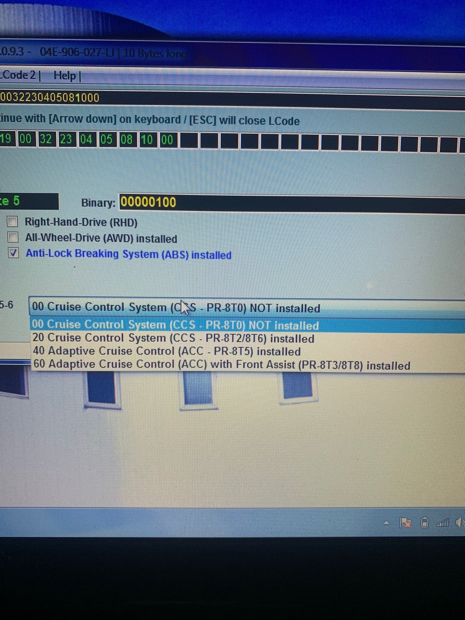

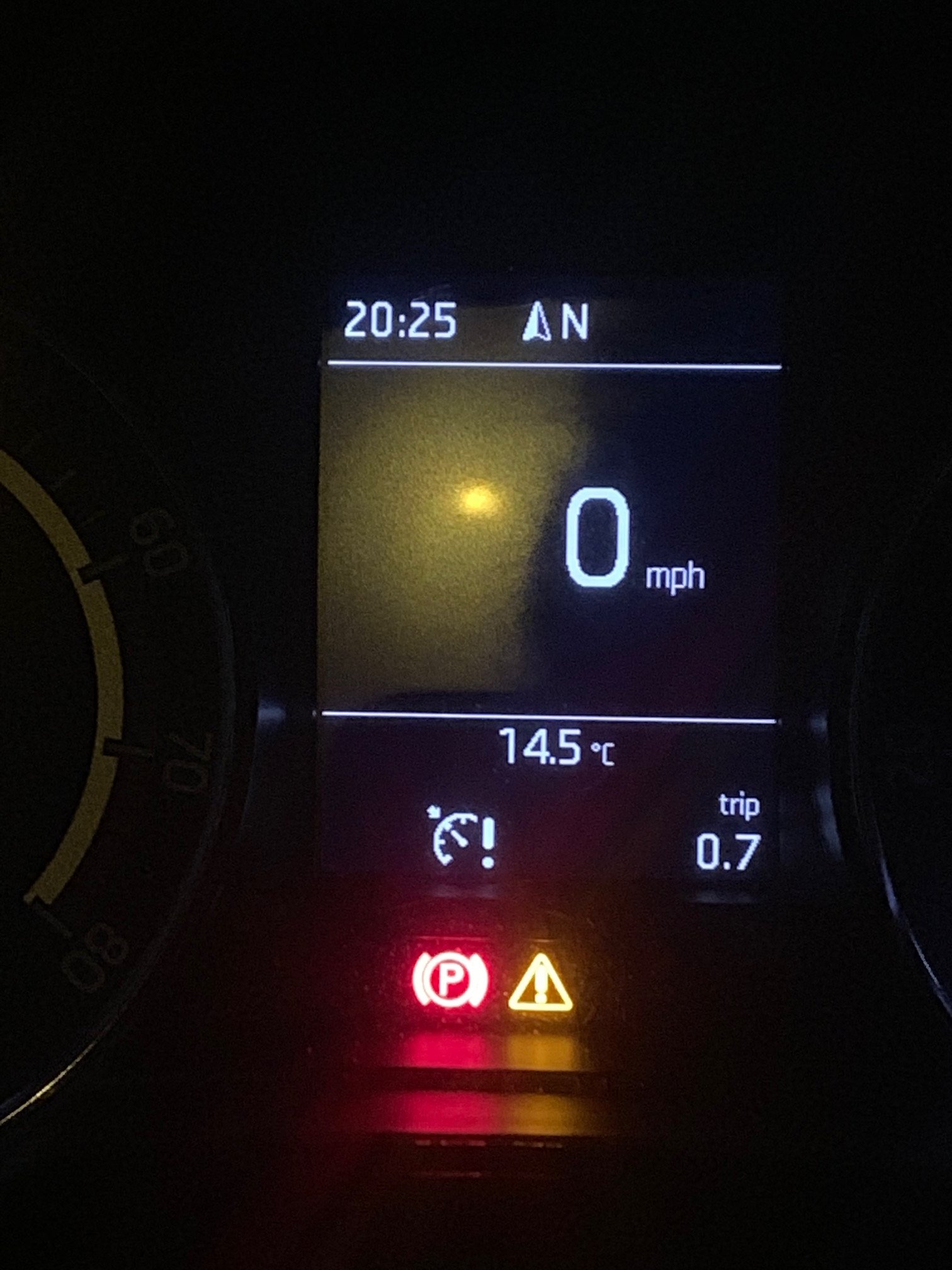

Just fitted cruise control stalks to my 2017 1.2 TSI Fabia but can’t work out how to activate it? As far as I can see I’m going to have to take it to a dealer? I’ve activated it on vcds but that doesn’t make it work and just brings up an exclamation mark by the cruise symbol and the EPC fault light? Does anyone also know what and where I put the activation code, activation number and PIN code, I’m fairly new to all this so any help would be greatly appreciated. Some photos are attached that might help.

Did you change that 00 value to 20 and save it?
Also have me checked that your car’s BCM can support CC and if necessary have you added wiring?
Edit:- the fact that the CC function symbol is now appearing must mean that you have changed some coding.
Edited by rum4mo
When I change the value from 00 to 20 and save it, that’s when it brings the symbol on, if I leave the value on 00 then my speed limiter works as normal.
Haven't checked the BCM so that’s something I’ll look into, however my car does appear to have all the hardware (like the accelerator pedal) which should theoretically make it work.
