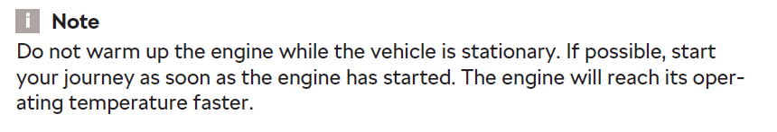

From every Skoda manual, regardless of engine...
