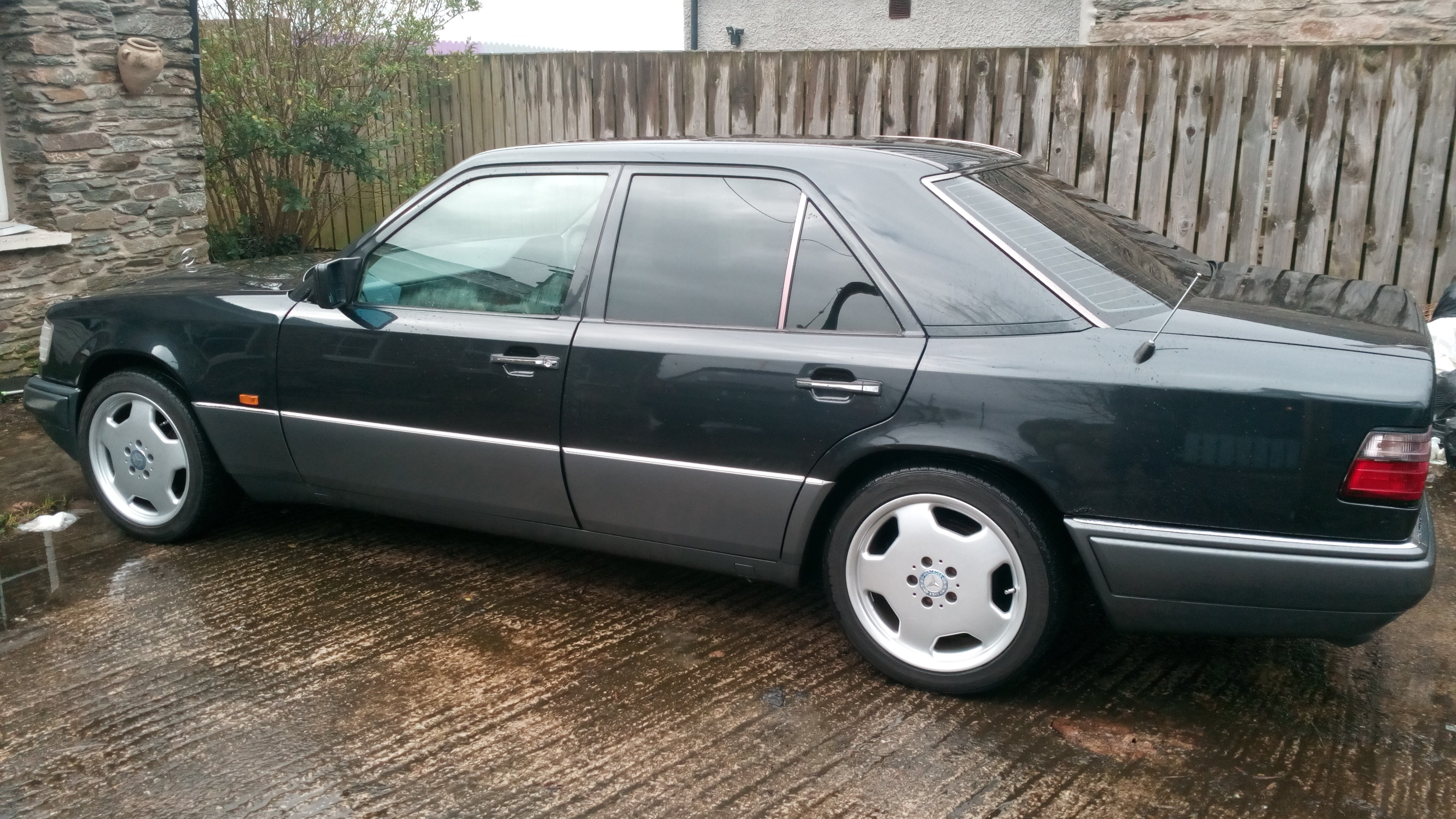

I don't I sold it 2 weeks ago and I am already regretting it, 2 years of trouble free motoring, don't know what I was thinking when I sold it to be honest although I had only done about 12k in 2 years so it wasn't getting used enough for a diesel, although it went to a nice couple who are expecting their first child so I felt good knowing it was a good car for them and safe.
I'm now tooling around in this..........
