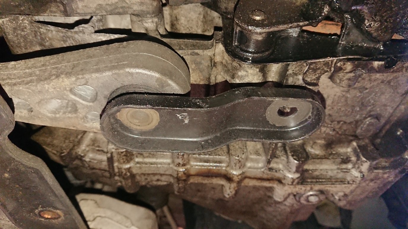

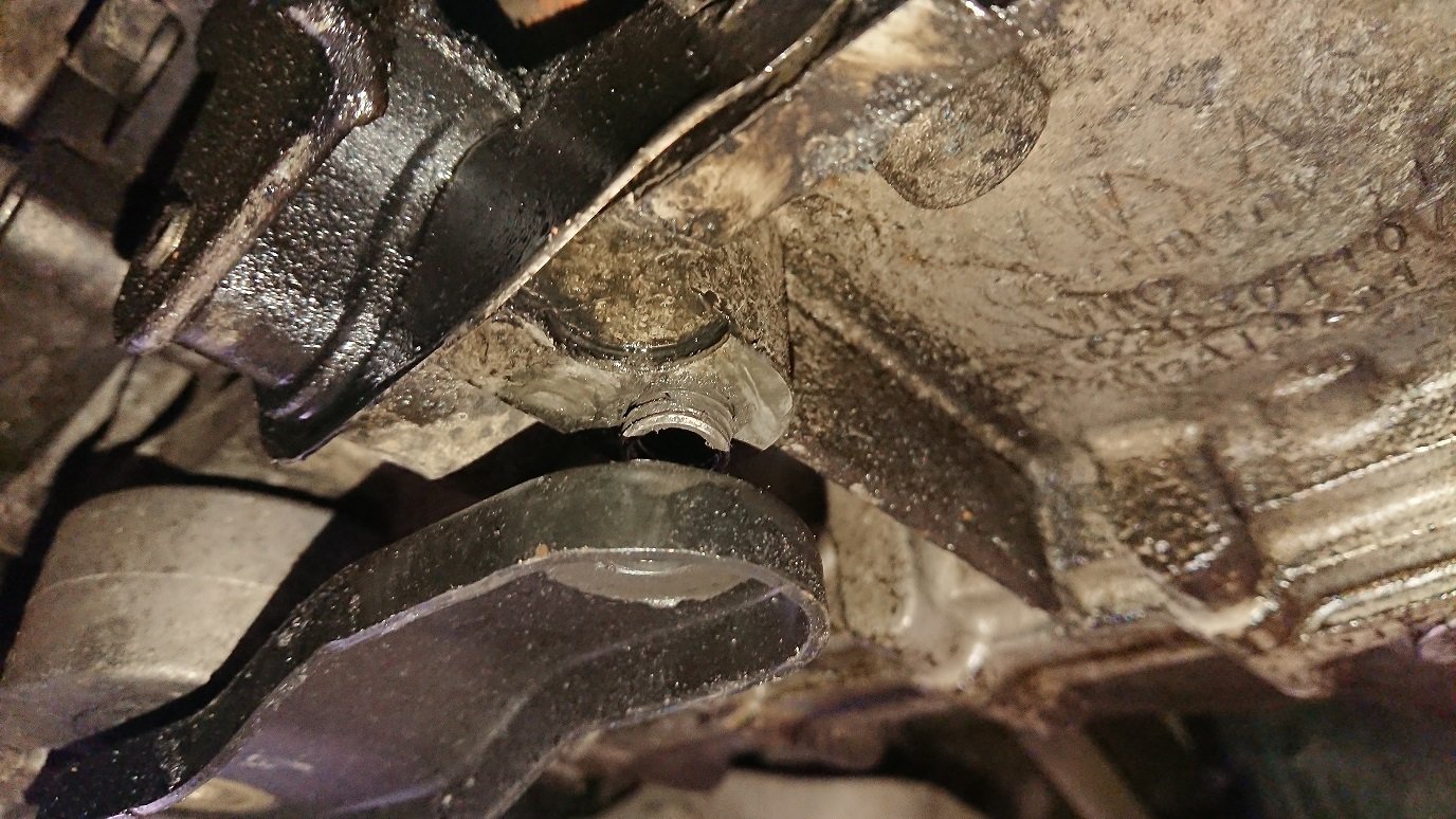

Found this dirty fix on the lower dog bone mount. Both bolts helicoiled but not looking great. Anyone had similar on one of these? fitted a timesert? Have experience of sorting this without replacing the gearbox? The the car is too good to scrap, rough round the edges but everything else works. It's a 2009 Scout PD with high miles.

Drama not too bad in the end. Helicoil had pulled out a we bit. This was removed and the hole reaped to m12. All nice and tight now. On to the top mount fix when bracket from darkside arrives.
