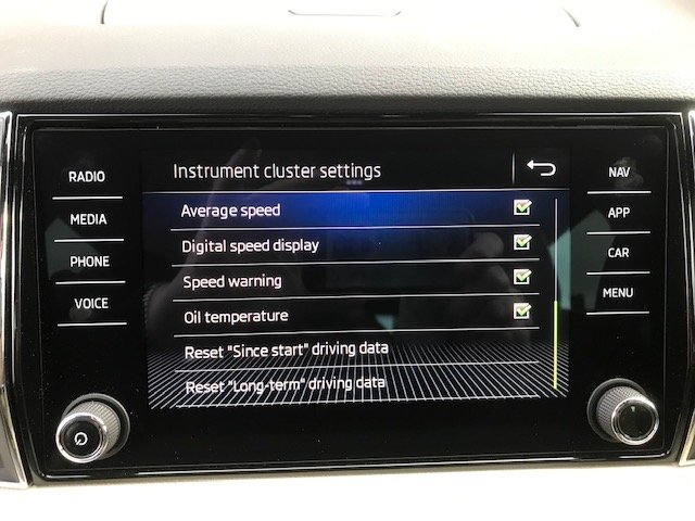

I’m on fixed servicing.....CAR.SETTINGS.INSTUMENT CLUSTER.scroll to bottom....
Thanks for the information. Oil temperature is now activated.
