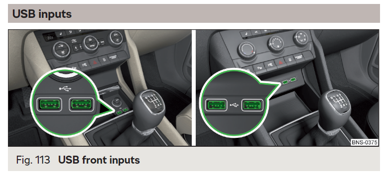

To get navigation you will need to use your mobile phone, and hardwire connect it to the car via the USB port (standard on the Ambition)...

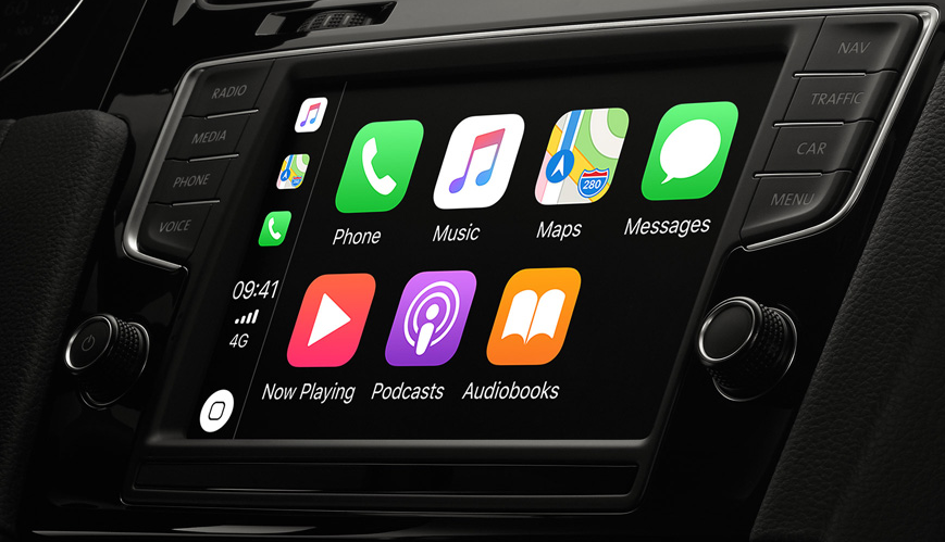

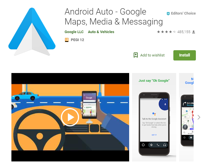

You will then need to download Android Auto or Apple CarPlay to your mobile phone, which will allow the phone's screen to be projected onto the Bolero display using the wire / USB connection...
Once the phone is connected to the car you will need to download a third party navigation provider, such as Google Maps, or Waze...
