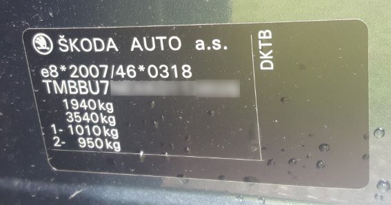

Where can I find my spec sticker in the car?

The spec sticker should be in the spare wheel well.
Hi, i've taken the spare wheel out and had a good look around and I cannot find it. Would there be anywhere else it could be?
Thanks
I can't find anything like that in my spare wheel well either - or anywhere else on the car.  Unless you mean this on the pillar behind the driver's seat(which I don't think you do)
White sticker on boot floor that looks like the one below (minus red annotations!)
Not sure if still fitted to newer ones but my 63 has one it's not in the spare wheel well but to the left of the flat part of the boot.
1176-1400153437-7e3c65bd50b6afcb9871d502
I guess it isn't put in new cars - there is definitely nothing like that on mine although I remember seeing it in previous cars
I definitely don't have a sticker like that in my boot.
