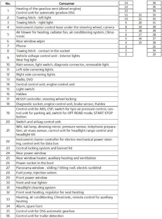

could anyone tell Me where the switch for the interior boot light is?
Also does anyone know the fuse location?

The removable light in the boot is number 10 so I suspect probably on that too.

The only problem I now have is that all the other items listed for that fuse work fine.
so looks like the switch is buggered, just got to find it!!!!!!

i haven’t got any power at the plug, the fuse is ok, so assume that it is a switch issue. Just cat work out where it is!
Not unusual to have the switch for boot lights to be on the negative side and something as simple as a gravity switch in the circuit. There is certainly no noticeable pressure/push switch.
Modern VAG cars have micro switches within the locking mechs
