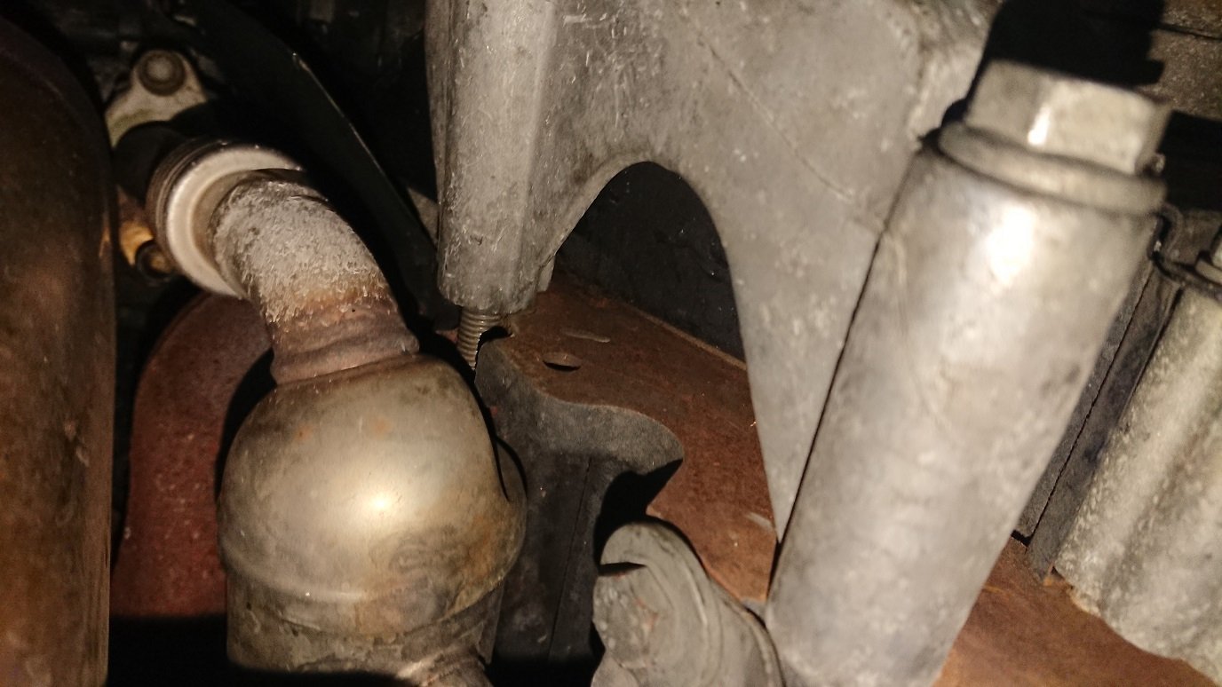

So I know I got myself a wee project run about, '09 Scout 2.0 tdi BMM, and so far not so much to sort, but we are on to the big problem.

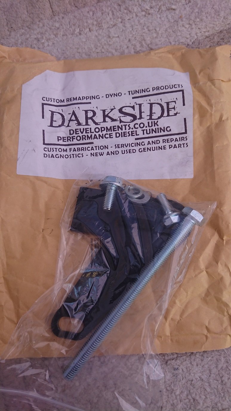

It looks like the last time the cambelt was changed the stretch bolt wasn't replaced and/or not tightened properly and the result is the top mount near the cambelt has broken the back of the block off.  Google tells me this can happen and ushered in the purchase of a bracket from Darkside Engineering. My question is has anyone had experience of fitting one of these?

I just need to know this bracket fix malarkey works before I get my wallet properly out in it.

So does anyone know if removing egr etc from the top would make it possible to get to this location and fit the bracket? I've looked from underneath and it looks a pig.

Shouldn't have got too excited about sorting this. Seems i didn't know/spot that this doesn't fit the 4x4. The garage just rang to let me know as they had come across this before. Thankfully they hadnt done any work on it  yet. Not sure where we go from here at the moment.
State of play. Darkside have seen the photos and are confident it will fit but as it requires DPF, EGR Cooler and potentially propshaft removing the garage suspect its an 8.5 hour job so over £500. Which if it doesn't its a bit grim to bear.
Currently I am contemplating buying some big boy pants, any tools I haven't got for the job, growing a pair and take my time over the job! Good bye knuckles, sanity and my swear quota for 2019. At least i'd know the car well by then, What you recon?

You are absolutely right and that is what I'd like to do. However last night reality dawned I just don't have the time as I am conkers deep in some other projects, one being a house renovation, and I really need the Scout to be functioning properly quickly. Darkside have been really helpful via email and have repaired Octavia 4x4's before with this bracket and have never not been able to complete the work. The only risk seems to be the egr cooler in that it is quite close, but they have seen photos and are sure it will be ok. Worst case then is there is a different egr cooler apparently that gives more space at the back of the block. I could argue that whilst its all off i put a new one in whilst at it as that appears to be a £100 - £200 on ebay.
