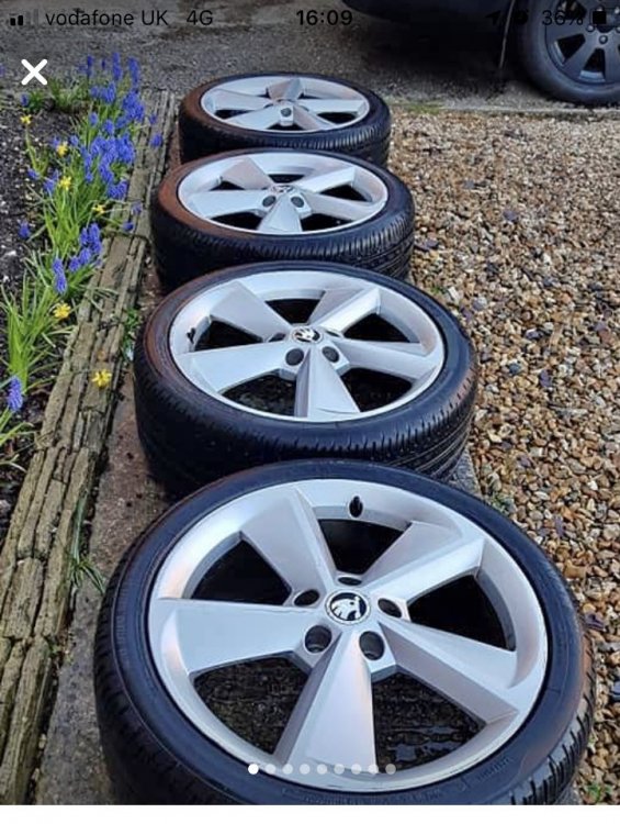

Has anyone put these on a mk2 fl? Just wondering if they will go on my 2011 elegance.

Look like 18" Golus from the MK3 Octavia. Can't help with your question as I never owned a MK2 Octavia, but they will be 112mm to the centre of the holes.:thinking:
@Nuclear_Jules - If @shyVRS245 identification is correct those have the correct PCD and centre spigot. Can you post the size info? (something like 18x7.0ET42 is the format you're looking for).
Wheel dimensions: 7.5J x 18“, ET 51
Tyres: 225/40 R18
Same as the neptunes afaik
Tyres: 225/40 R18
With those measurements they should fit ok.
they'll go straight on
