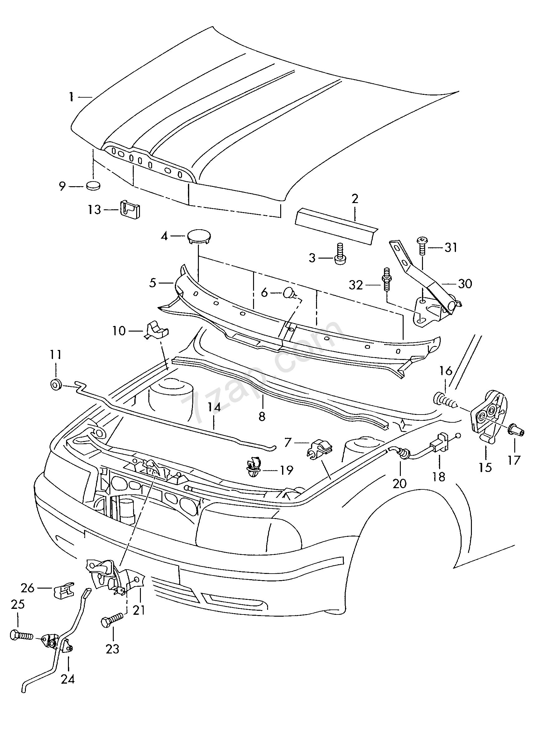

Is the cable attached and moving at the cabin end? Start with the obvious i spose..
This might help figure out where things are and how connected..
Thank you for exploded diagram it may help

You see part 24 in Mac's exploded diagram; that's also awkward to make work right.

Providing the exploded diagram to help identify a position from which the cable could be pulled down closer to the latch mechanism was my point..

could you sneak a hook through the right most gap in the crash beam onto the cable, and pull it? I cant remember where the cable route actually goes, over or under the body frame.
