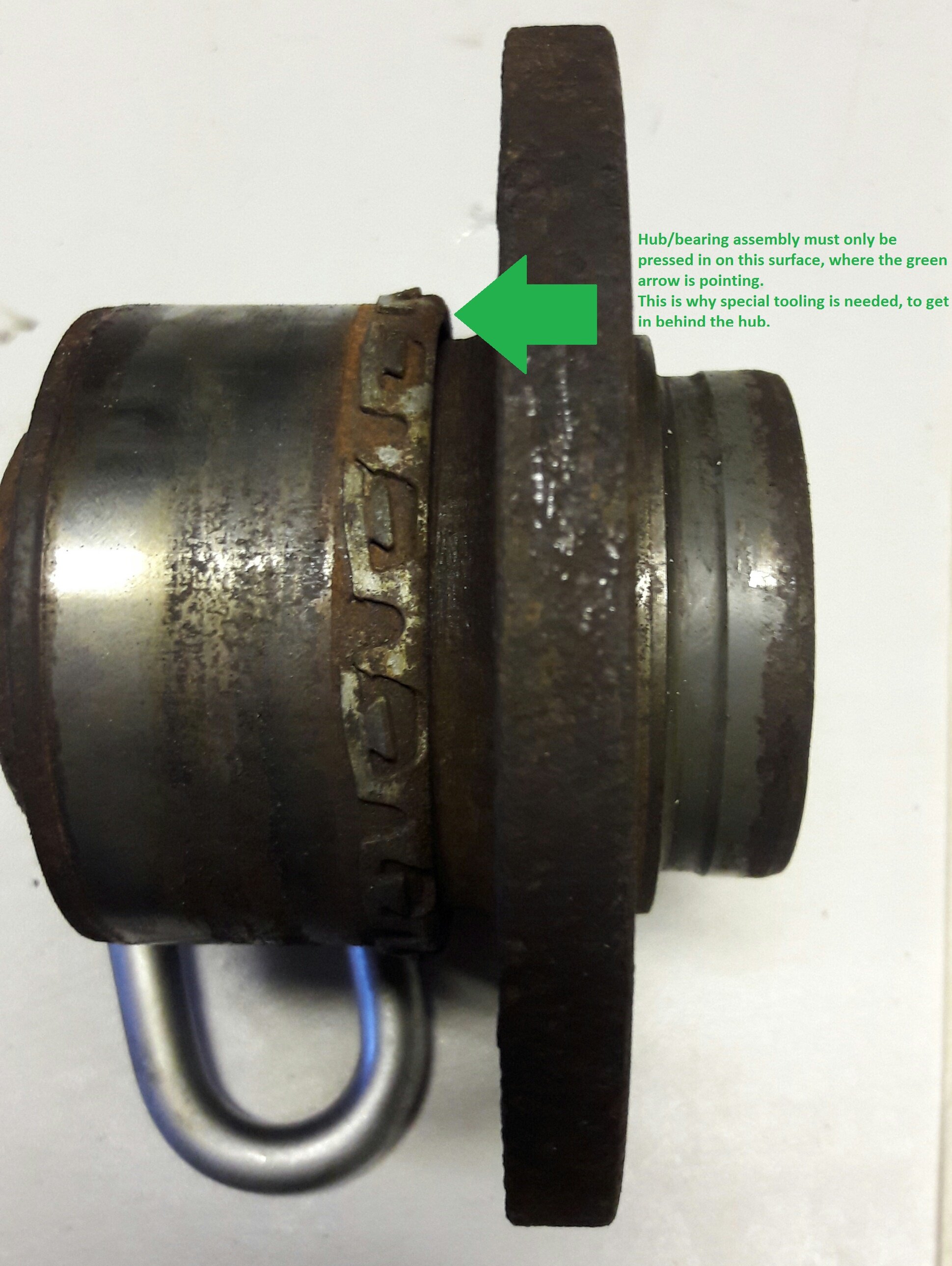

There's a lot more to it than that. You need special tooling to get in behind the hub and press/push there. See this:
Pushing on the hub surface (instead of using this tooling)  is the same as pushing on the inner of the bearing, and will cause damage.

Here's a photo of the hub/bearing combination, showing where the tooling needs to push on during installation:
