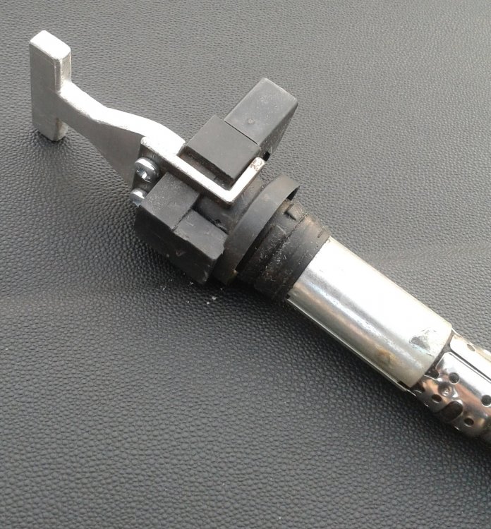

I use a homemade puller tool, but I reckon this youtube method might actually be easier.  (Certainly if the puller isn't in the car that I'm driving at the time of need). Will feed back when I've tried it.
I've got a set of coil pullers, but as you say Wino, these nasty cable management clips live very dangerously - still just as nasty on my daughter's later 2009 Ibiza. My original method of easing them up was to use 2 smallish longish screwdrivers but that relied on the cable management plastic tolerating being slightly abused by these 2 screwdrivers pressing down on them.
