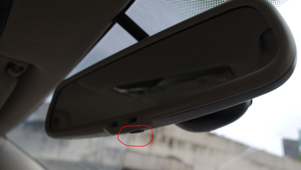

If your mirror is like this one, there is a button on the bottom side, when you press the button a green led will turn on and the auto-dimming feature is activated.
Attached you can find the electrical diagram.
Duh! Seen the led, never noticed the switch:(
