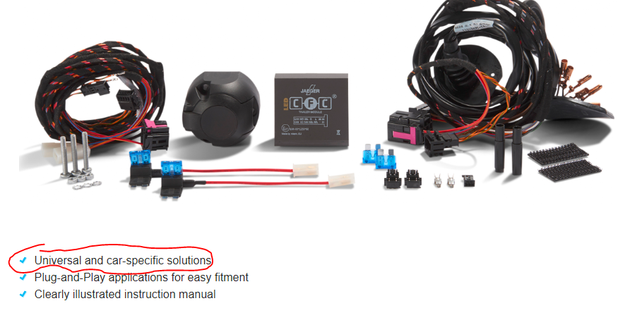

4 minutes ago, silver1011 said:
So which one did your tow bar fitter use?
'Universal' or 'Car Specific'?
i dont know :(
your opinion and experince with bosal oris
