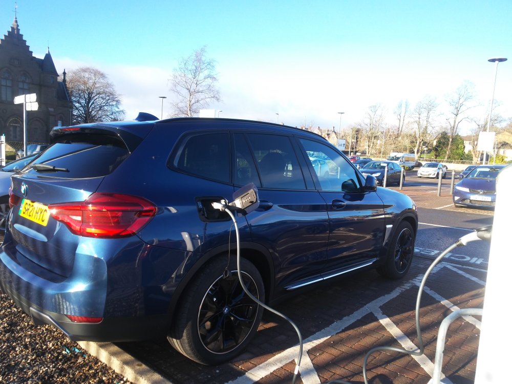

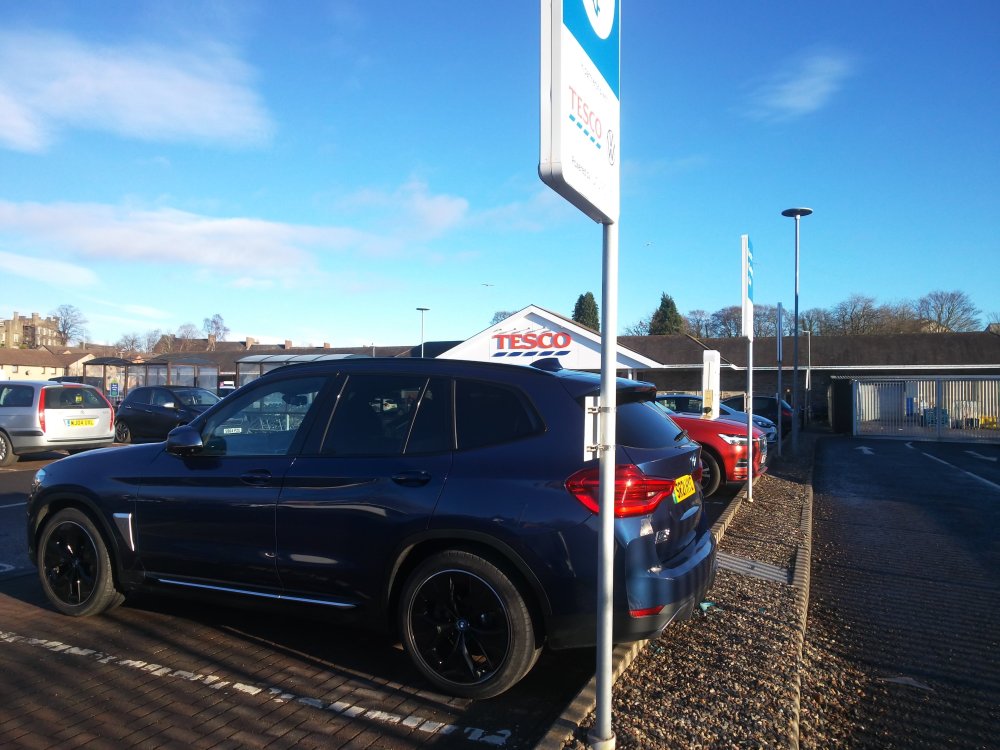

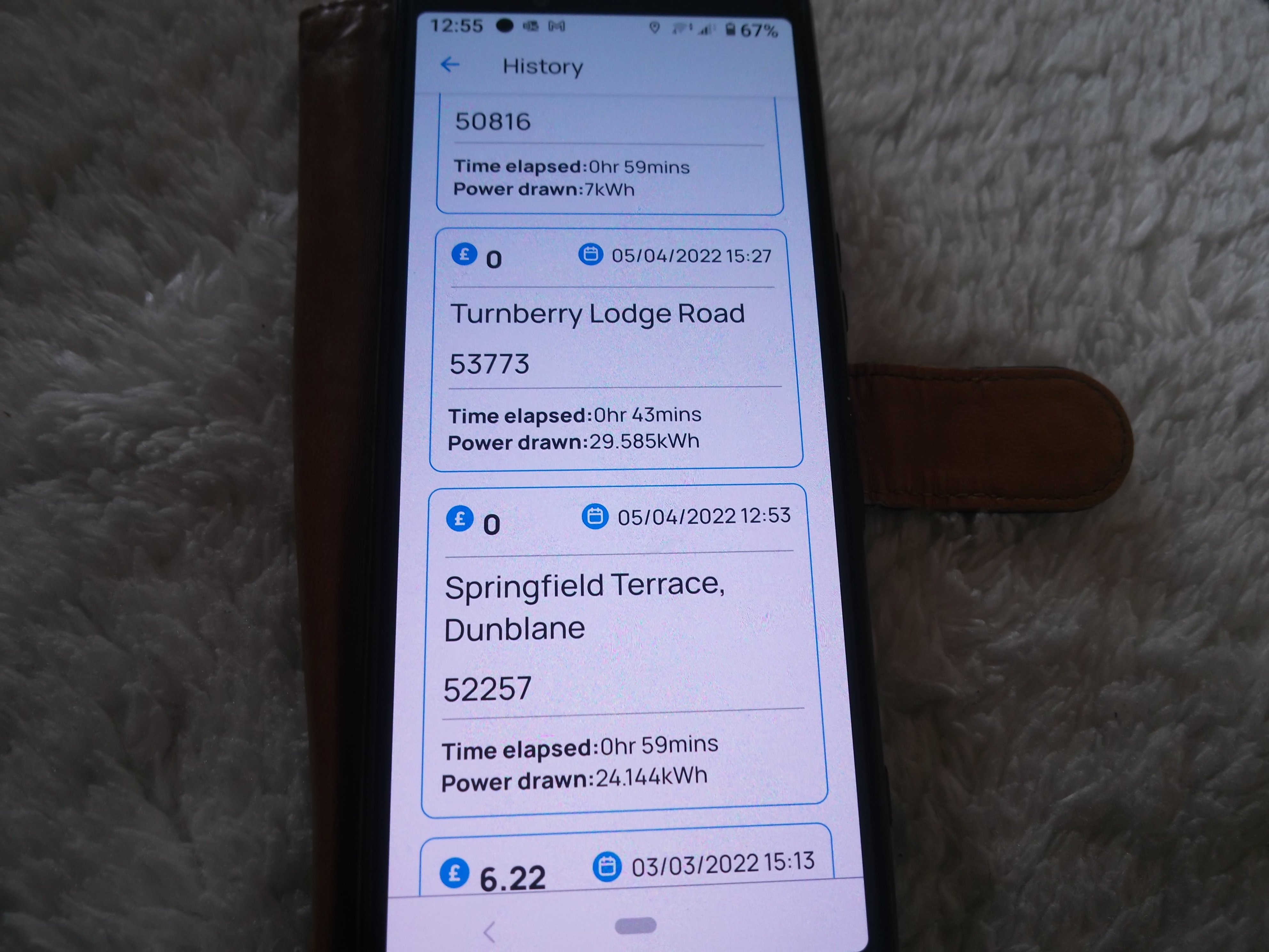

When you just want to get places and stop and get on a 50kW charger because that is all that there is available and you need to get a few miles in it drives people up the wall when a big battery car is parked on the only available for hours charging or maybe even fully charged.
Especially when they have a home charger but just want to top up free.
I would rather be paying to charge and have to pay over stay charges and stop the greedy that are as ignorant to hog a charger.
I never got on the 50 kW after being here an hour so now have to find an available charger in the next 20 miles.
Edited by roottoot

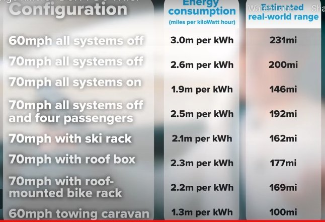

I just met the first Tesla driver I have that was towing a caravan.    I was at a single 50kW charger that took 3 goes to get started and then was dead slow.  So in pulls the Tesla S with a big caravan towed.  He reversed and unhooked the van.  Got his left rear reversed to the charger.  He was trying to start the charger so I got out and asked if he was going on the AC.  No he was going on the CCS.  I told him I was going to be 40 minutes as the next 2 chargers were occupied.  He was ok and was going to get his type 2 cable out.     As it was I stopped charging and let him on as the speed was so bad.     So he was 140 miles  from home and said he gets half the range towing.  No idea if he had already done a top up.    I am on a charger 6 miles up the road and he just passed.  So he had 30 minutes charge max if he did get any charging.  I know the next charger is out of order but he might have enough to go the 20 or so further to the next chargers and his destination..  the whole thing is a lottery on a very very busy weekend of sunshine and showers on the South West Scotland coast.  Not the usual ferry traffic though   lots of campers and a few EV Nissan ones about.   Hailstones now, this morning my cars battery was so cold I could not have the radio on while sitting not charging, sun came out, got much warmer and for a while the car was efficient.
Edited by roottoot
Which will come as no surprise to people who've towed caravans.
@KenONeill
We need to get to know if actually interested more what EV drivers say they get or do get because knowing you will half your range for what ever the temperature is and road type gives people something to make their decisions on about getting an EV if they are going to be towing.
I have towed for over 40 years and always with automatics, and petrols, diesels and LPG's, that is all sorts being towed and for gain or reward.So  boats, caravans, car trailers etc and  i do not get or expect double the fuel consumption from what the vehicle gets solo, but then it does very much depend on what the tow barge you have is.
If any did use double the fuel then it would be punted unless the double the fuel was still acceptable as solo it got pretty good economy.
The Tesla driver was charging for free and gets free Tesla Charging so the need to unhitch maybe every 120 miles will not be such a PITA .
Lovely to get on the road and not have to splash the cash other than on the vehicle you use normally.
With some EV's if you want to tow, have the car warm in cold weather with passengers, put bikes or boats on the roof and head away then maybe lots of charging stops will be necessary if going far.
