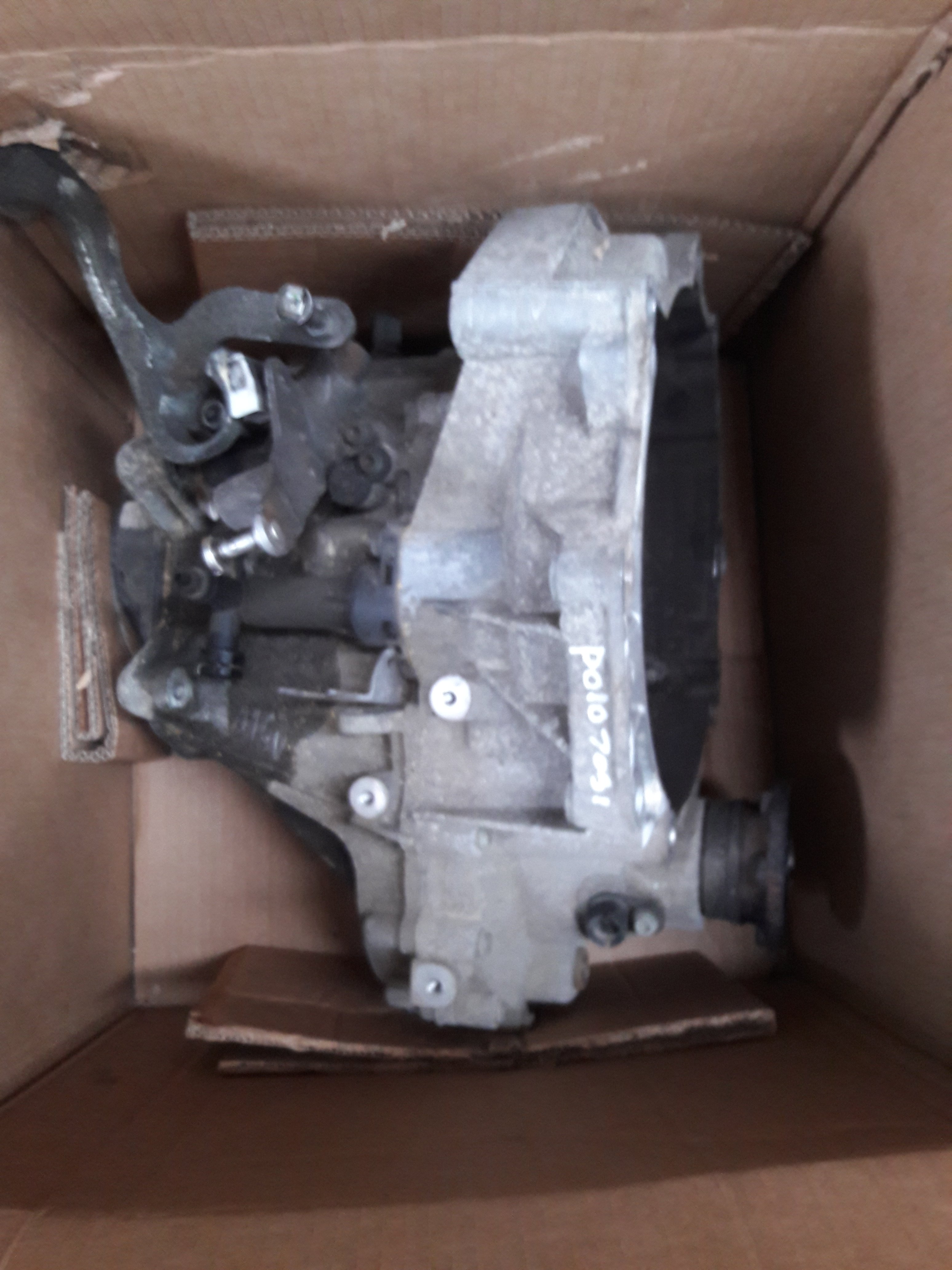

Ordered this fella first thing yesterday morning, off a Polo that had done 69k apparently. Just arrived.
Gonna swap in a new lever and release bearing (also just arrived), will transfer the slave cylinder across from the old box, as it was new at the time of the clutch job.

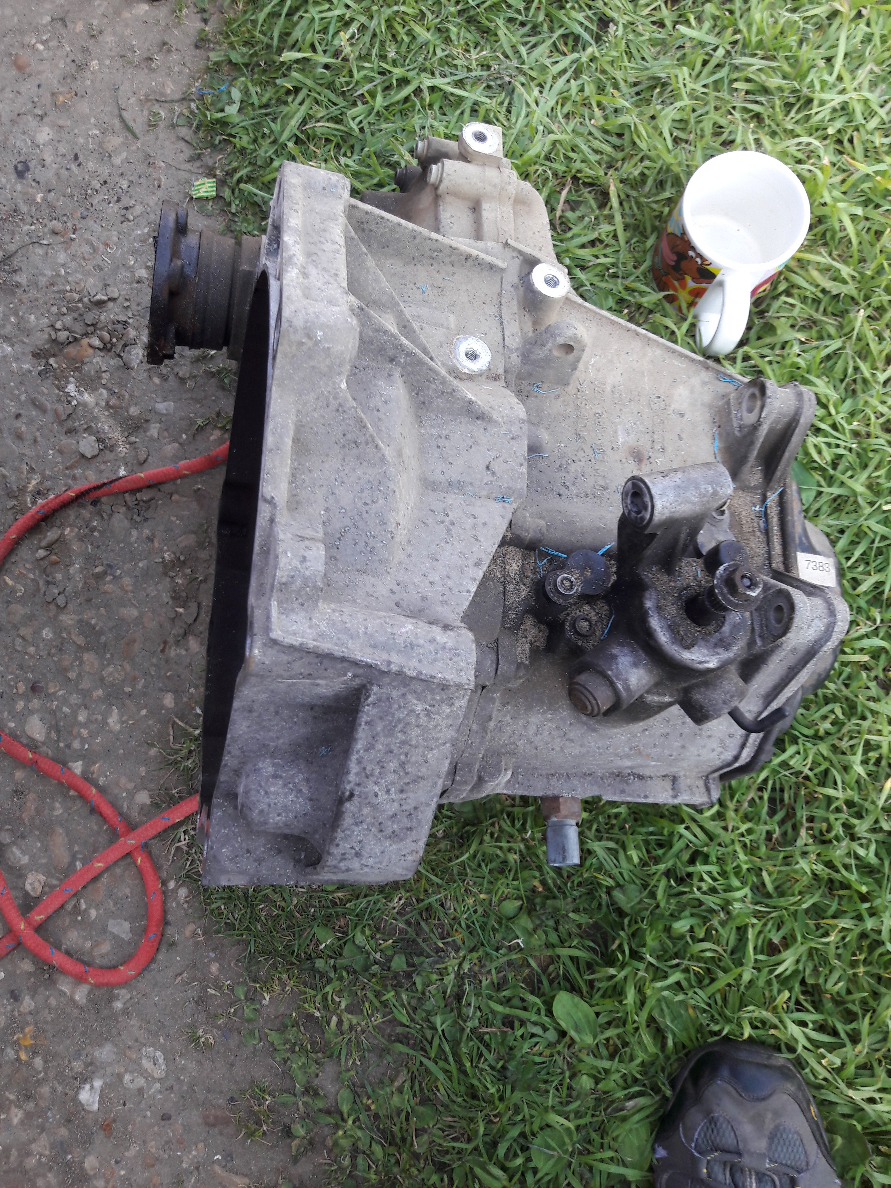

Out with the old:
Wow, quick work! :thumbup: When's the replacement going on?
  • Sponsor
Thanks; for me that was very quick.
Tomorrow is the plan for fitting the replacement.
Working conditions are considerably more pleasant than for the clutch job in late  December 2016! :biggrin:

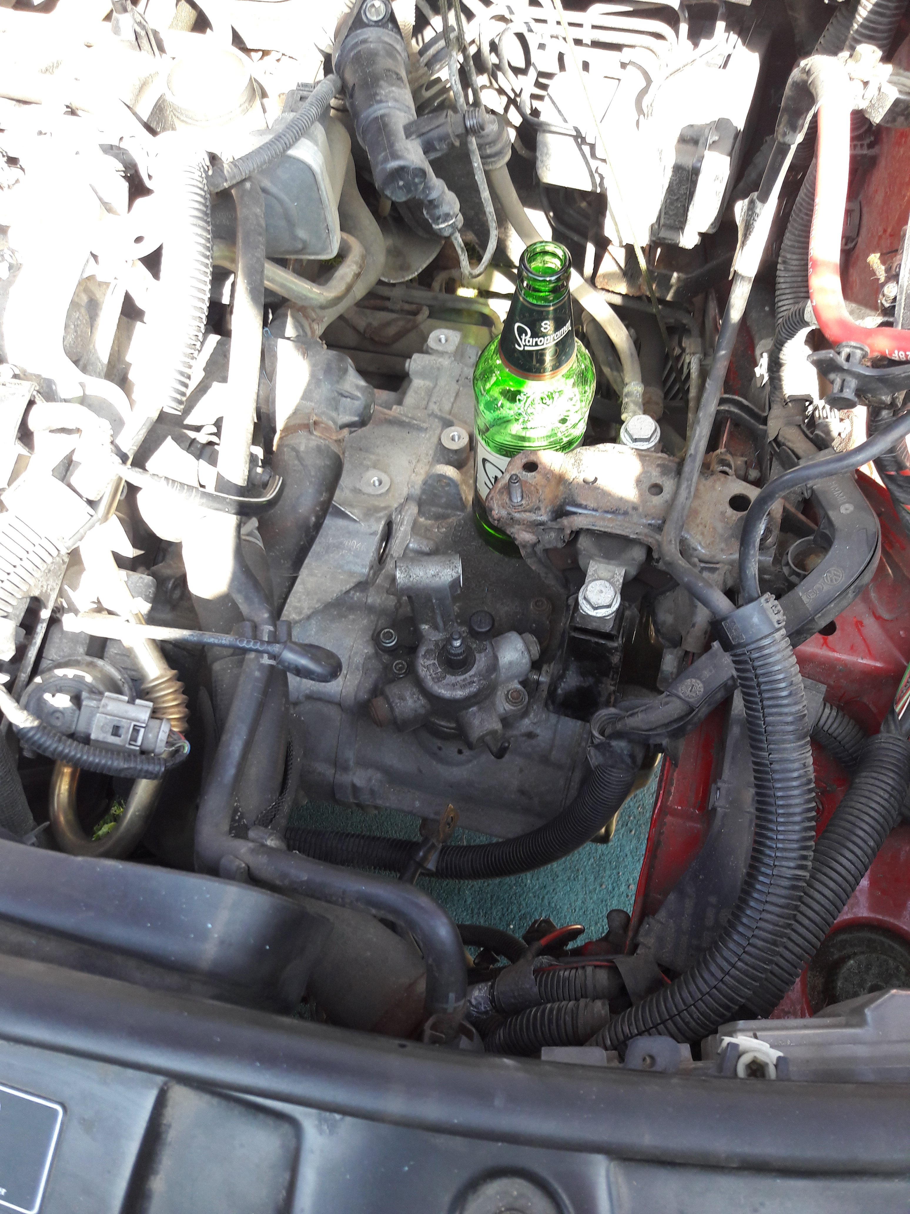

Another good day. New release lever/bearing fitted to the 'new' box and then a couple of litres of new oil went into it.
More of a battle than expected getting the thing back up into position but it was bolted on in time for a late lunch.
Most of the work's now done, but didn't fancy pushing through to complete it today, I make mistakes when I'm tired, and there's no real rush.
Nice one. Was gonna suggest a new release bearing, so glad you fitted one. I see you had some liquid refreshment on hand :biggrin:
  • Sponsor
The lady owner of the car went out specially to buy me beer in time for lunch!  :)
^ Great stuff! Mrs. Wino must be dead chuffed :D
