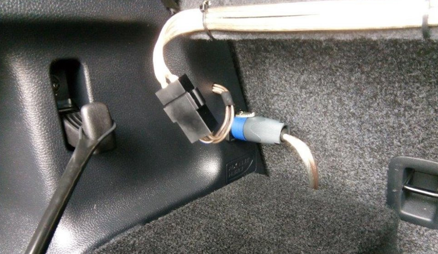

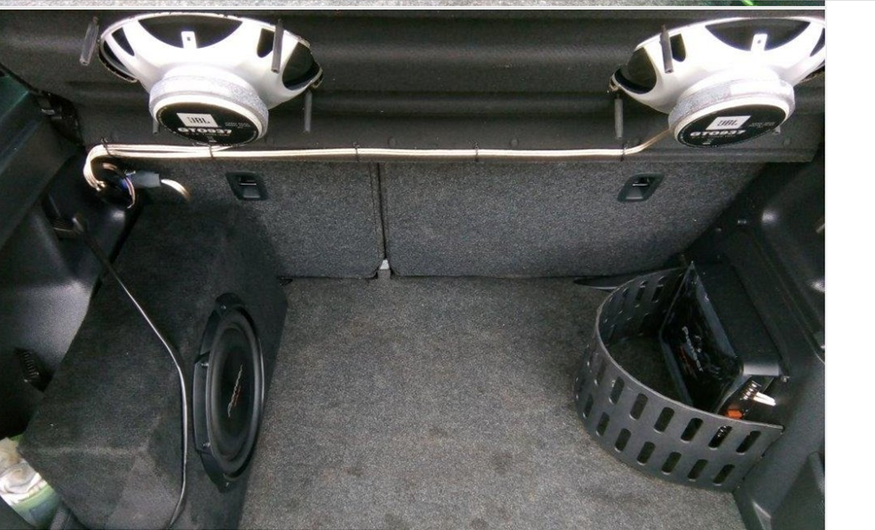

Ive done  quite a few mods to the sound and found initially that wiring 2 rear speakers to the parcel shelf and shifting the 'balance' of the music from 'Front to Rear' was enough for a good few years whilst other mods were pursued. Had to get an car audio firm to wire from original stereo. The power output is quite good.
Also wired with Quick Release fitting so i can still remove parcel shelf if need be.
 This was cheapest option, only 6 years later did i add a new android stereo then a subwoofer from the android unit.

That is a really neat installation! How did you sort the power remote? My plan (if I ever get the time) is to splice the rear speaker leads just before they head off to the rear doors and then route cables to a converter in the boot. Then there is the problem of power to the amp. I'm not really keen on routing a cable all the way from the fuse box to the boot. Ten years ago, no problem, but not sure I could be bothered these days. Forgive me for thinking this, but I'm not going for a lot of power here, so I'm having thoughts of splicing the supply to the rear 21 mm power socket. Problem is it will probably only me 1,5 mm2 at best, but it would be so easy.. We'll see. Also depends on how I sort the power remote for the amp. If I have to route a cable all the way from the stereo, I might as well do a 6 mm2 cable to the amp at the same time.

Kobayashi's job looks very similar to the old Toyota Yaris way of fitting rear speakers.  Toyota had extra speaker ports on the audio system, I just had to pop it out, connect the loom, run that through the car via the door sills, under the carpet, etc, fit the speakers into the shelf and Bob's your auntie's hubby!
I think they ran from the drivers side, rather then passenger/nearside but very similar, right down to the plug connector!
It was a proper Toyota setup though so it may be that you have no actual plug in facility on the back of the audio system.

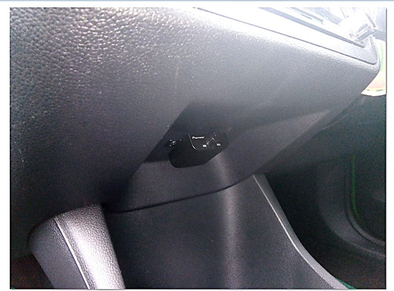

The power output from the original skoda dance / swing is quite good, the original installer told me not to bother with my fliptop pioneer from my corsa.
I didnt do any of the wiring but it works independently of the amp / subwoofer, wired to the ignition.
One thing if you still want to take out the parcel shelf to fold the rear seats then you want some 'quick release fittings'
The subwoofer BASS  volume has no remote so to speak but was 'wired' underneath the stereo.
