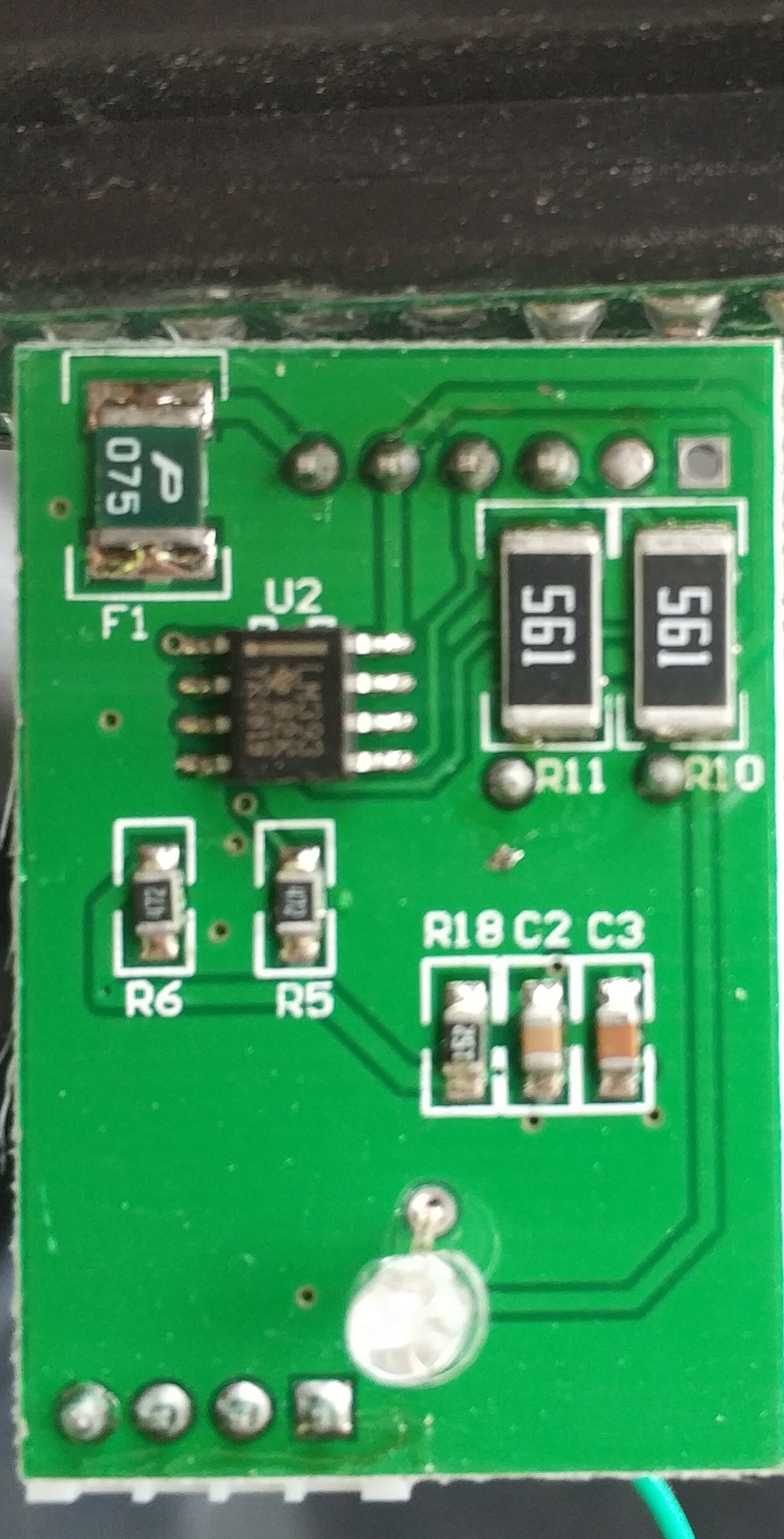

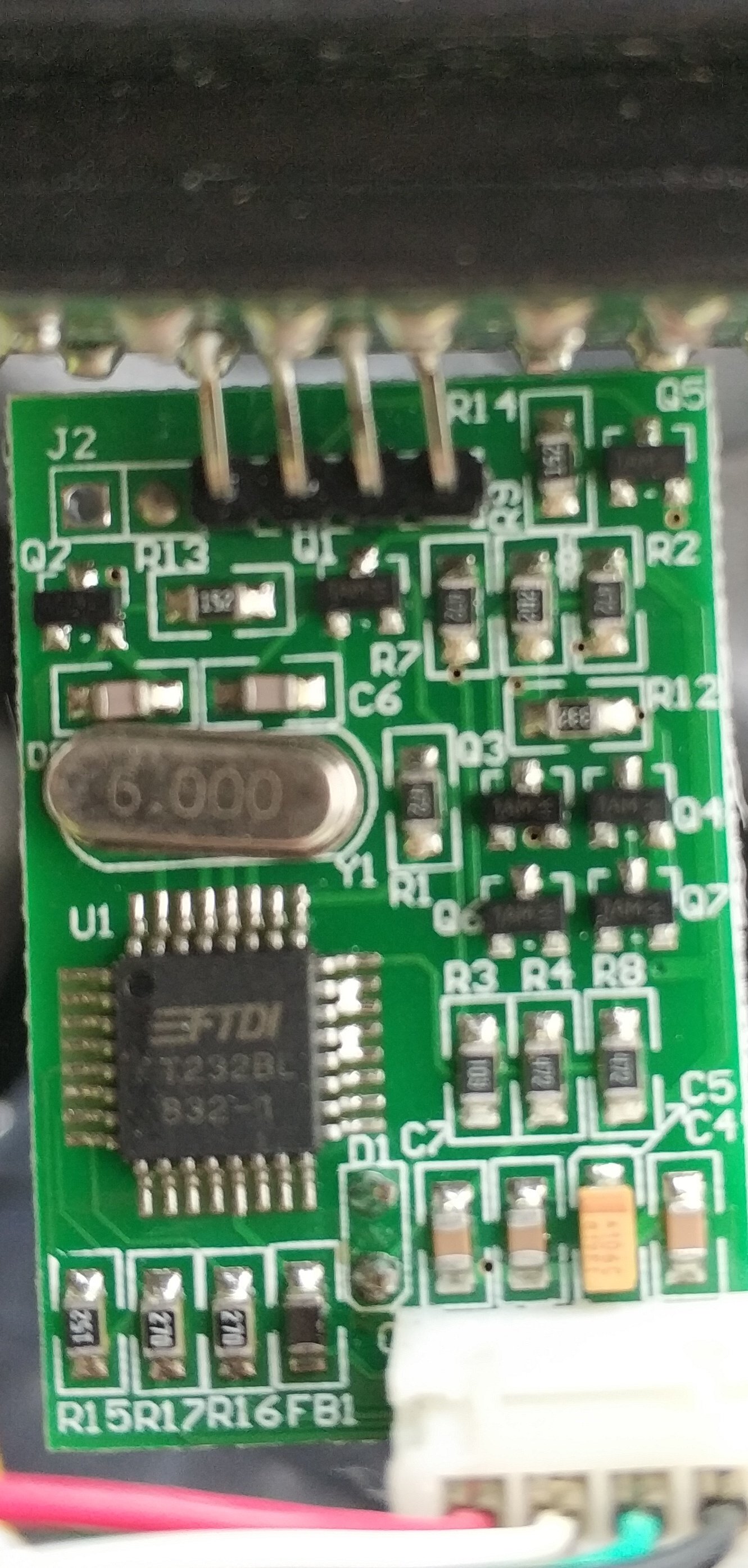

I think I've found the lead I bought for my old Audi don't know if its any good for vcds I'll attach pic if anyone can tell from the pcb of it?
