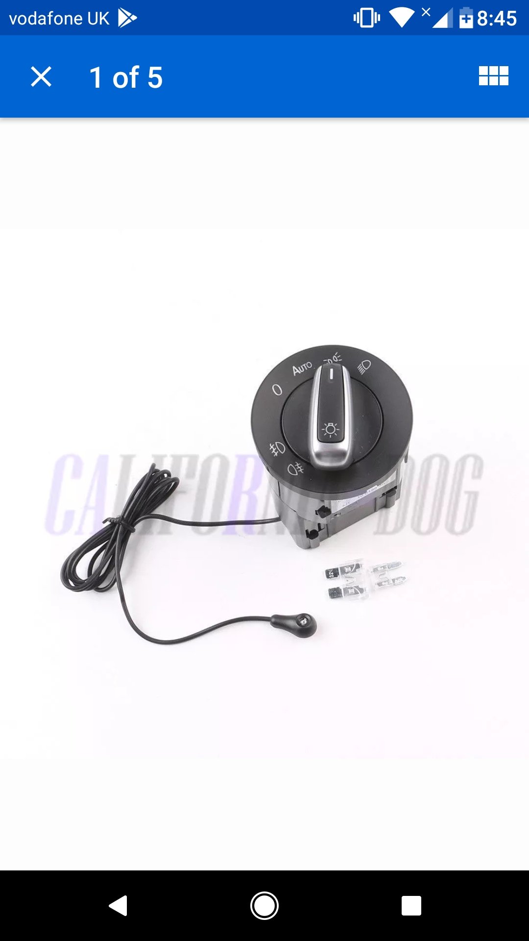

I retrofitted a new headlight switch which has the automatic headlights function,

How does retrofitting automatic light switch work without fitting a light sensor ?
Or am I missing something ??
My Astra has auto lights, with no off function, absolute pita !!!....
It is a replacement switch with a light sensor built in.
You swap them over and feed the light sensor round to bottom of the windscreen.
I originally wanted a switch with the front fog light option but the automatic switch was half the price.
