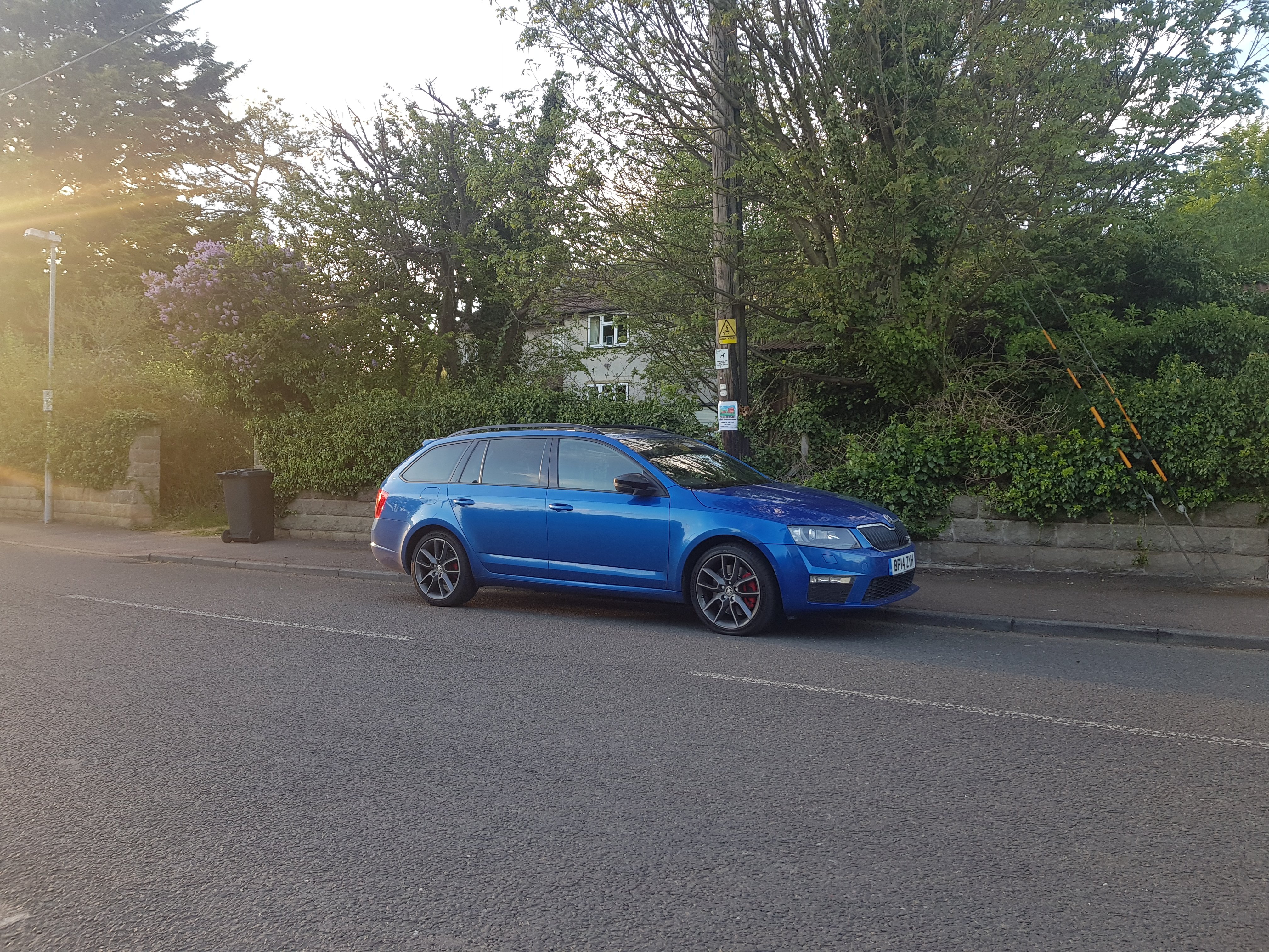

Yesterday I bought a 2014 Octavia VRS 184. I'd love to show some pictures off but as I'm a new member I don't think I can! Upon buying the car it had been stood for a while with multiple error codes on carista (sp?) but were cleared.
