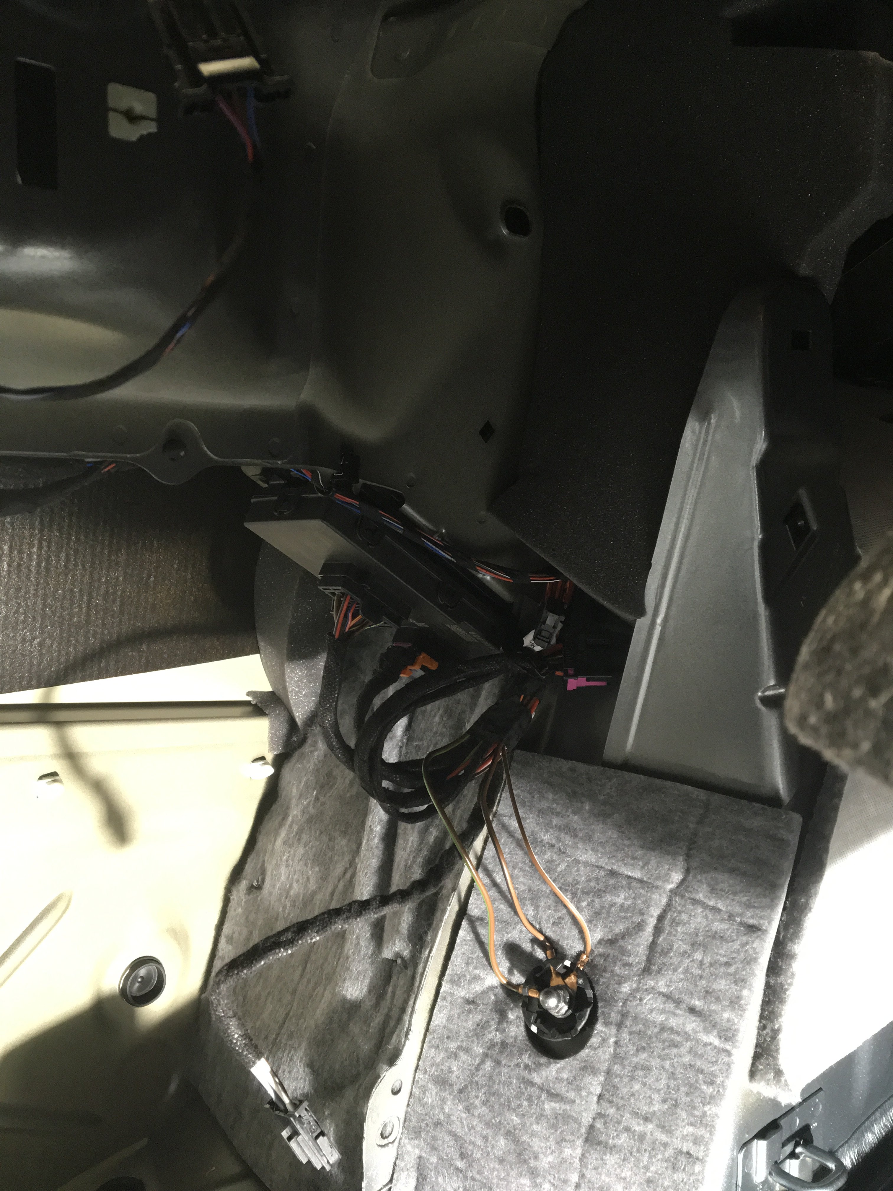

Hi, Ive fitted two Westfalia towbars to both of my mk3 Superbs 2016 sportline 190 4x4, and current 280 L&k. The first did not include the prep and the second did but on this the prep only included the cables in the side of the boot to the fuses at the front. This meant I still required purchasing the full electrical kit for the bypass relay etc. so only saved me the time of running the cable to the front and connecting to the fuse panel.:angry:
Thanks Martin201, where will I find this 'prep' please, I'm guessing I'll find some cabling, hopefully with some kind of plug on the end, behind the lining in the left hand side of the boot? As is it obvious what is what?
Hi Paucatuman, it’s on the left hand side behind the wheel arch on the L&k where the subwoofer is.
