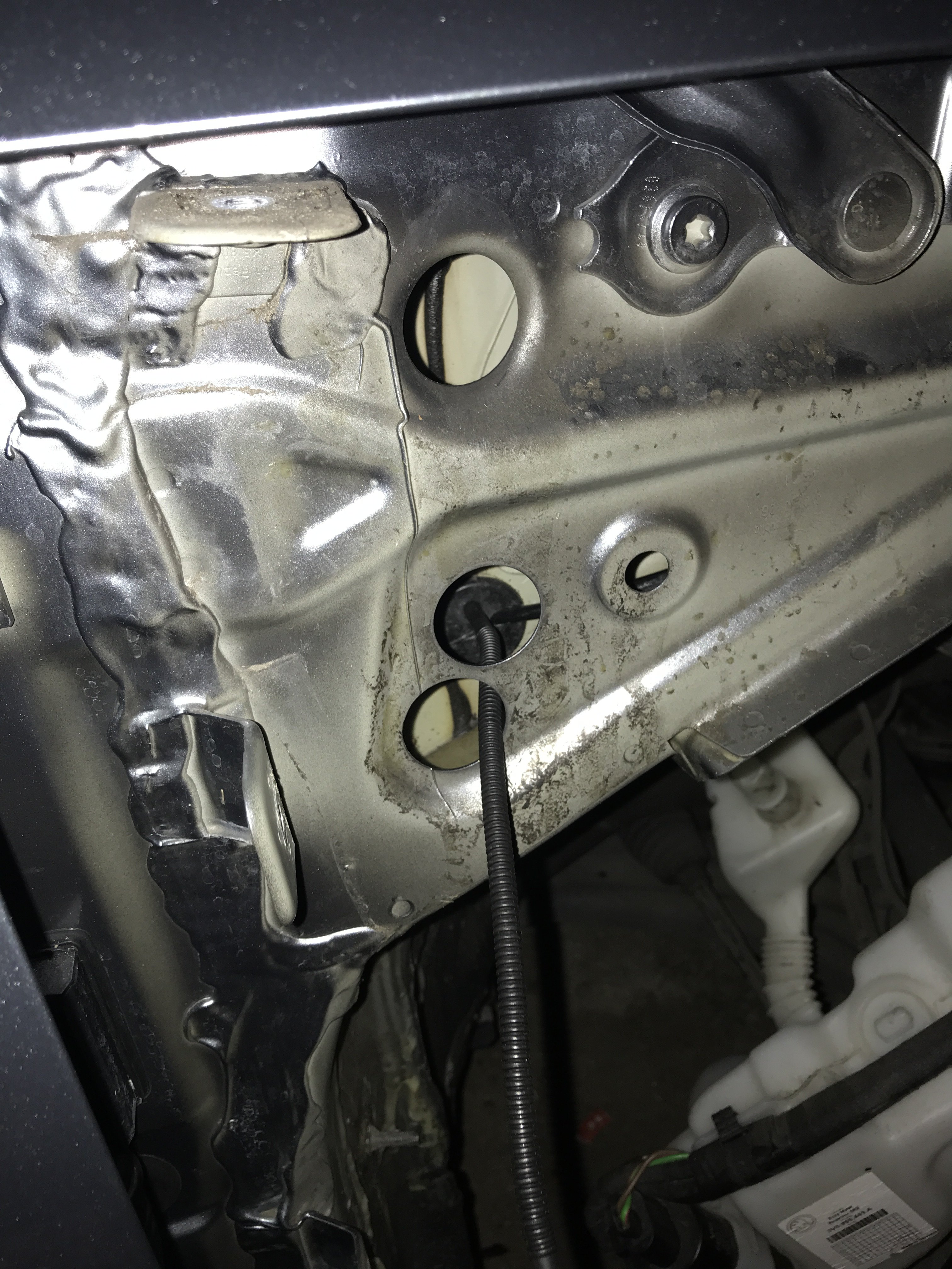

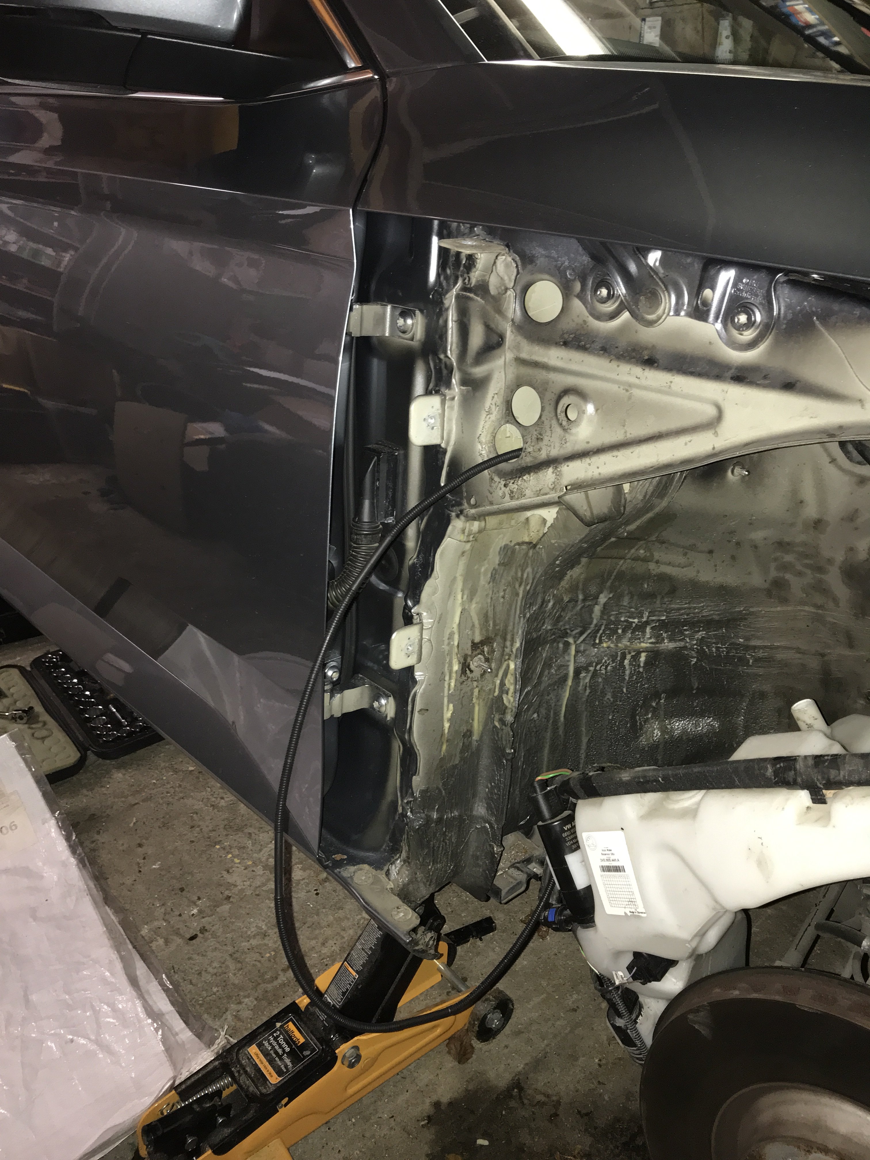

  4. Hi, I found a hole with unused grommet through drivers footwell when I fed a washer hose from washer tank to new rear camera. For access I removed the front wing which was not a problem at all.
