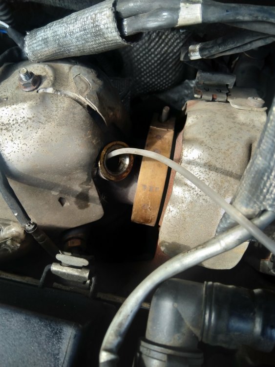

So will I just bend a wee hose connected to Mr Muscle can through that sensor hole in my pic towards the turbo?
Yep that’s it.
