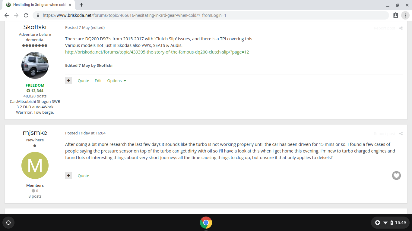

It turns out the clutch is slipping. More obvious this morning. Strange that it doesn't do it when it's up to temperature though.
Booked in for an inspection but not happy when it's only done 9k miles.
Will certainly not be keeping it up to 18k.
As long as the Master Tech or the Tech does not say 'never heard of that before'.  They just need to check the TPI on your age of DQ200.

I'm a bit worried about the gearbox now. Having read about the DQ200 issues I regret buying it. Even if the dealer replaces it, what happens in 2 years time when it goes again?
When or if the warranty provider Skoda / VW UK replace the clutch packs and do a software update the Warranty is only as long as the Manufacturers Warranty lasts,
so 3 years, or the 12 months of a Used Car Warranty, so ask / fight for a 2 year warranty extension free due to the 'known issues'.
 Then when that expires buy a Skoda Extended Warranty.  They will sell it and should not then say 'Known Issues' because supposedly they are dealing with the 'Known issues' and resolving them.
