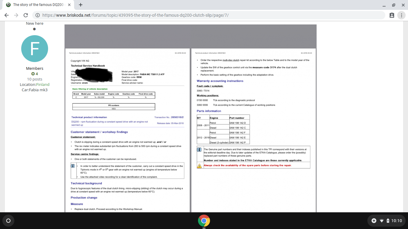

The issue is not how many millions are produced totally reliable and issue free from the 2,200 DQ200 DSG that Skoda build a day for 48 applications rather that VW Group / Skoda
finally accepted that various they built can have the faults from 2015 on and they are doing something about it, but it requires the owner to be reporting the issues and getting past the Gate Keepers at Dealerships. Service Desk then Techs that get no Fault Codes of find an issue when road testing the vehicle.

Did you ask if there is a TPI covering your DSG's build period, and is there a Software Update, and upgraded Clutch Packs ?

The point is, there were 'faulty clutch packs' which is what the thread i linked and the screen shots above are about.
So as much as the techs might say there could be faulty clutch packs, there could be, and who knows is Skoda CZ that installed them.
So there is a TPI or there is not, but i know there are for various DQ200's from 2015 on,
so ask 'in writing' the Warranty Provider, as in Skoda UK Customer services, and they can say, or likely refer you back to a dealership. Who should have checked.

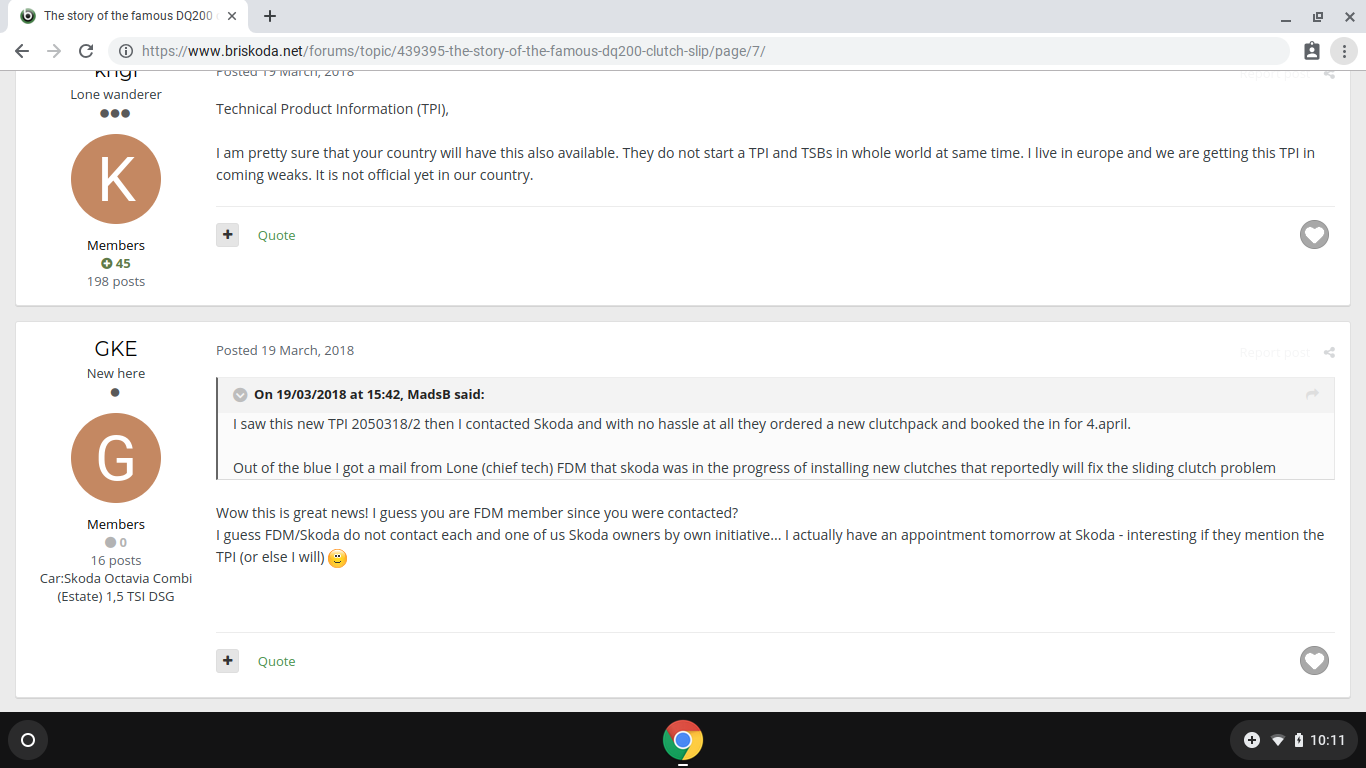

Has it been confirmed for certain that their is no TPI covering your date / series build of DQ200 DSG over clutch slip?

They are not checking for a 'Service Campaign',
they are to check the Technical Product Information that VW / Skoda had to put out because of DQ200 DSG from 2015 on clutch slip faults.

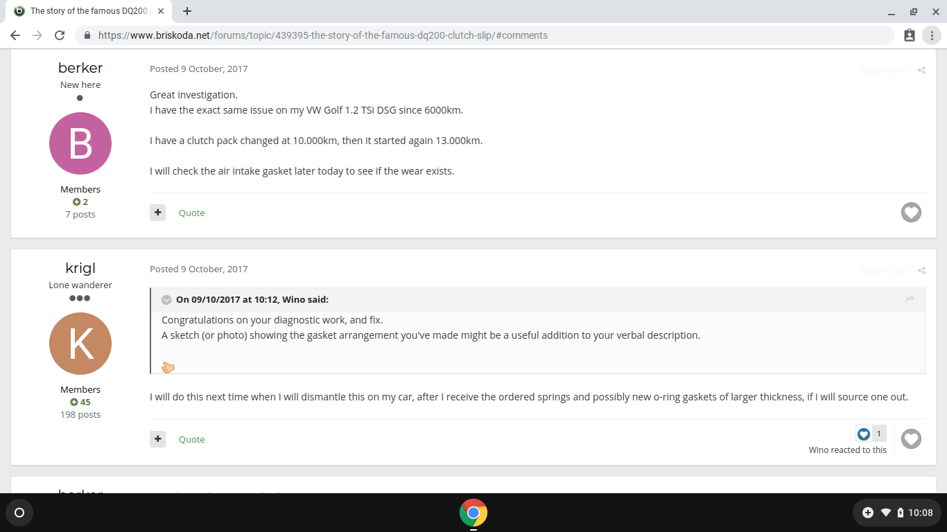

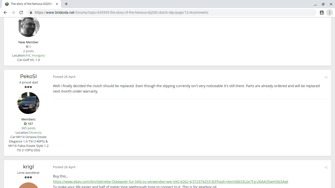

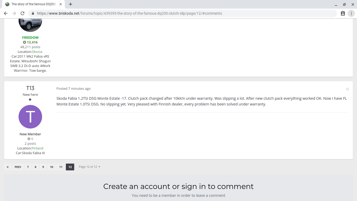

Posts from the Fabia MK3 section in the DQ200 Slipping Clutch thread.
These cars are from 2014/15 on.  1.2 or 1.0 TSI engines.
