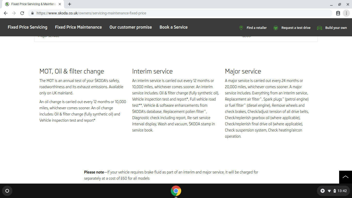

Thanks Skoffski
In your opinion the 2nd service does not need spark plugs and air filter, even though Skoda publishes this on their website.
The invoice details oil and pollen, not road test or inspection.
The website before it was changed recently was the Fixed Price Servicing on cars from 3- 10 year old.
So that would mean the Major service would be at 4 year old.
The 'replacement of parts' was stated as 'if required by service schedule' or such rubbish which meant people were paying the same price regardless of if
The Air Filter, Spark plugs, Fuel Filter etc were changed.
Be careful not to be ripped off.  Pay for what gets done and not for what someone decides does not need doing, and they dont even look to see.
