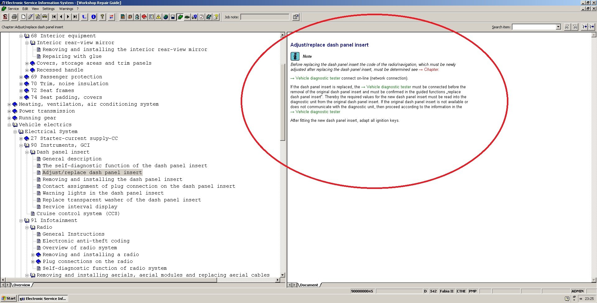

Adjusting the odometer is technically "illegal" unless you are fitting a new one which is zero miles OR one that has "less" than you current one you are replacing.
Most can be adjusted / increased, but unless your a prefessional car clocker they cannot go back the other way. You need just a diagnostic tool (good one like Vagcom) to read your current one and then follow the correct procedure to replace it.
(see attached image)
I have Vagcom but that will not read the pin or let me rewrite the eeprom memory. The new cluster is in mph and i need to change that to kph (imported part - a lot cheaper), i'm puting mk2 cluster into mk1 car so i need to change some variable in the eeprom to make the fuel gauge work properly. I've been reading on this "mod" and apparently i also need that pin (Vagcom can't read pin).
