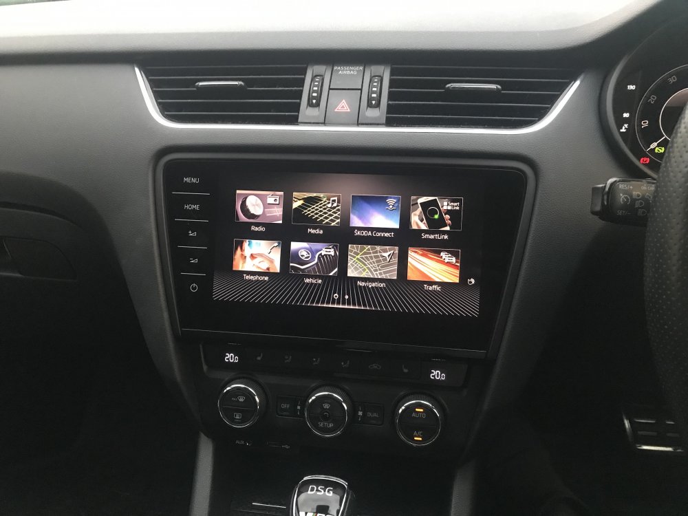

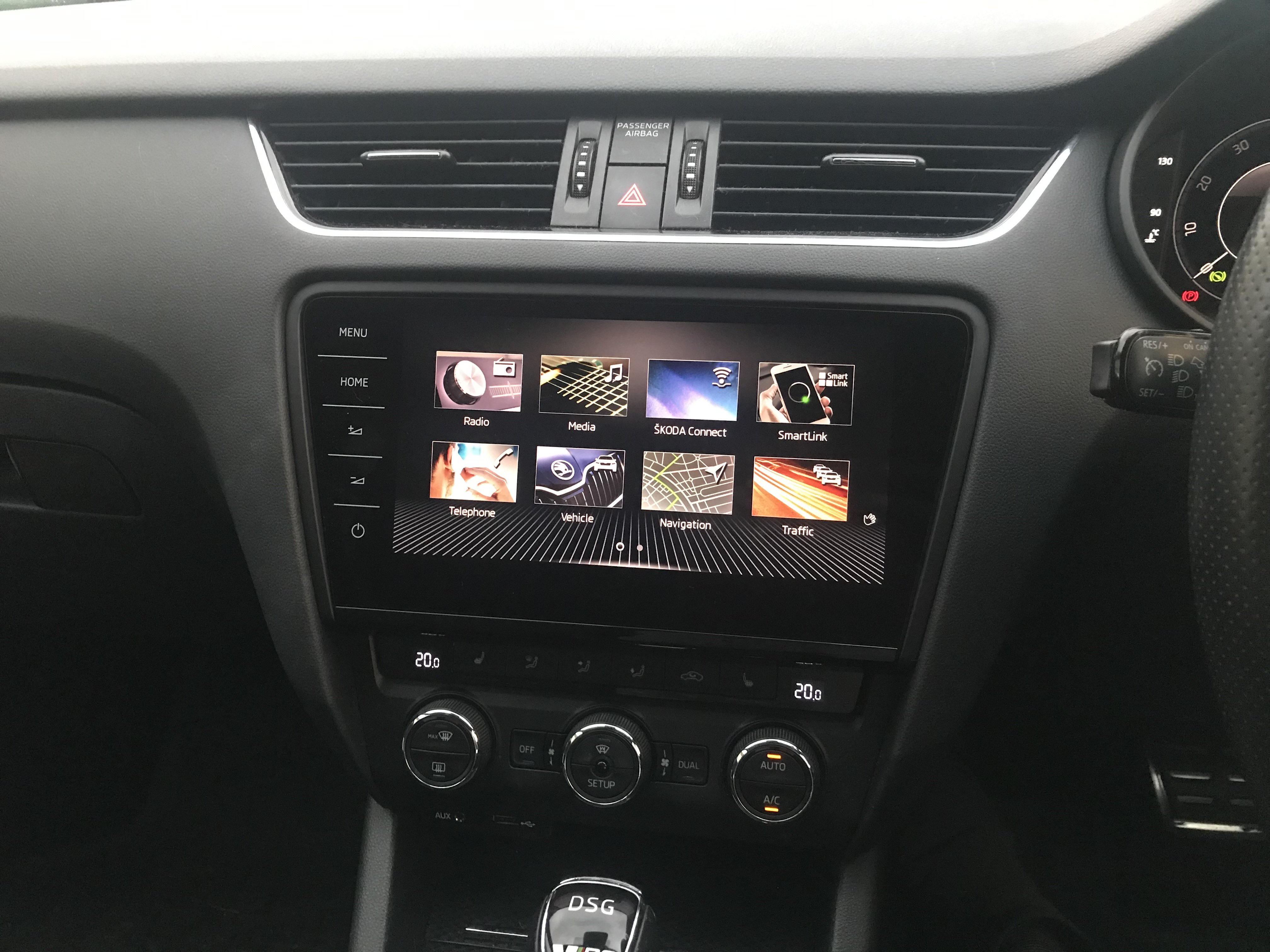

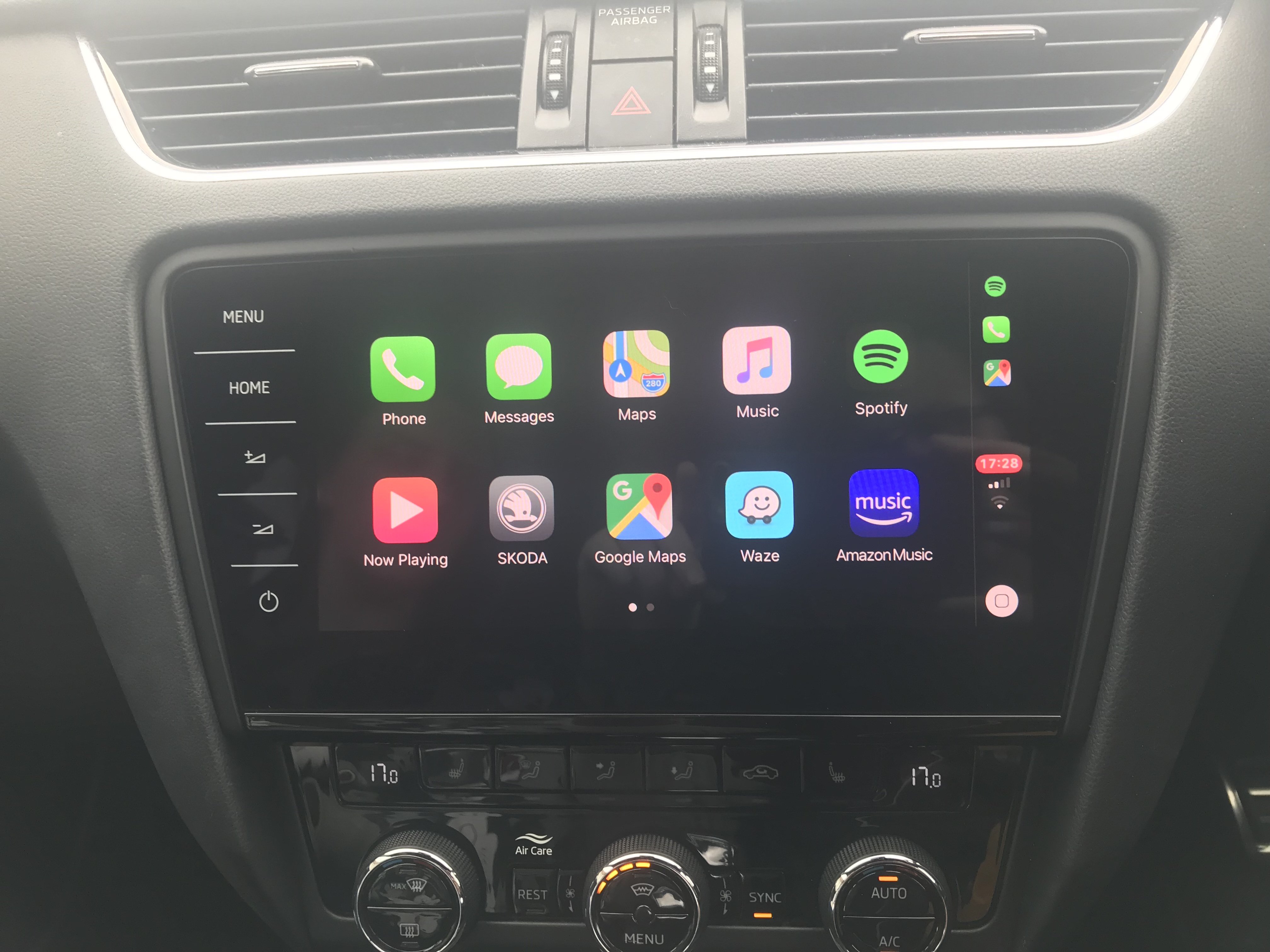

Once the FeC’s are disassociated, the unit needs a patch write to the motherboard and possibly some hardware changes to work in the car. It’s normal for these features to be lost during MIB swaps. Your radio and screen are fully compatible and there is no reason MirrorLink won’t work once all of the coding has been done. I started with a MIB1 Bolero, went to MIB2 Amundsen with Columbus screen and I now have a MIB2 Columbus modded to MIB2.5 spec running the 9.2 inch screen. My radio features all work as they should :)

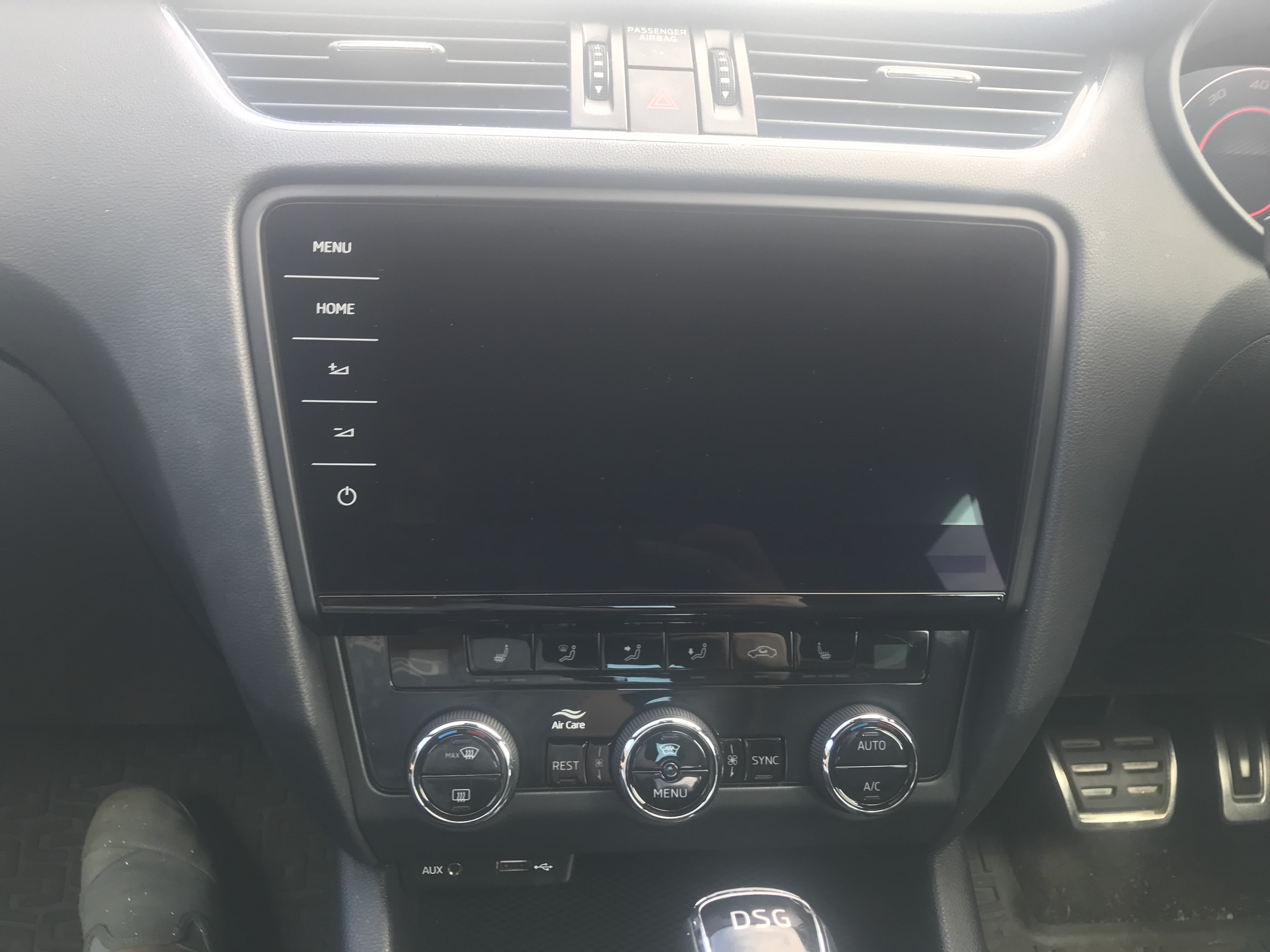

I outsource all radio work to Pawel (pab567 on here) who is from Poland but that's a non issue. His English is excellent and the quality of his work second to none. You would have to get in touch with him for prices as the unit will certainly require extensive hw and sw work to make it to MIB2.5 spec but I have always found him to be very reasonable and able to activate features that other people can't such as the Sport Menu, Media Command and even Skoda Connect if you pay the subscription. I love my 9.2 inch screen and I really recommend going for a newer screen as it lefts the cabin up massively. You can't update to MIB2.5 and keep an 8 inch display. The 9.2 inch display plugs in and works just like the 8 inch one normally would. The part number for the screen in 5E0919606D. I'll get some pics of my setup, or there are a few in my build thread.
