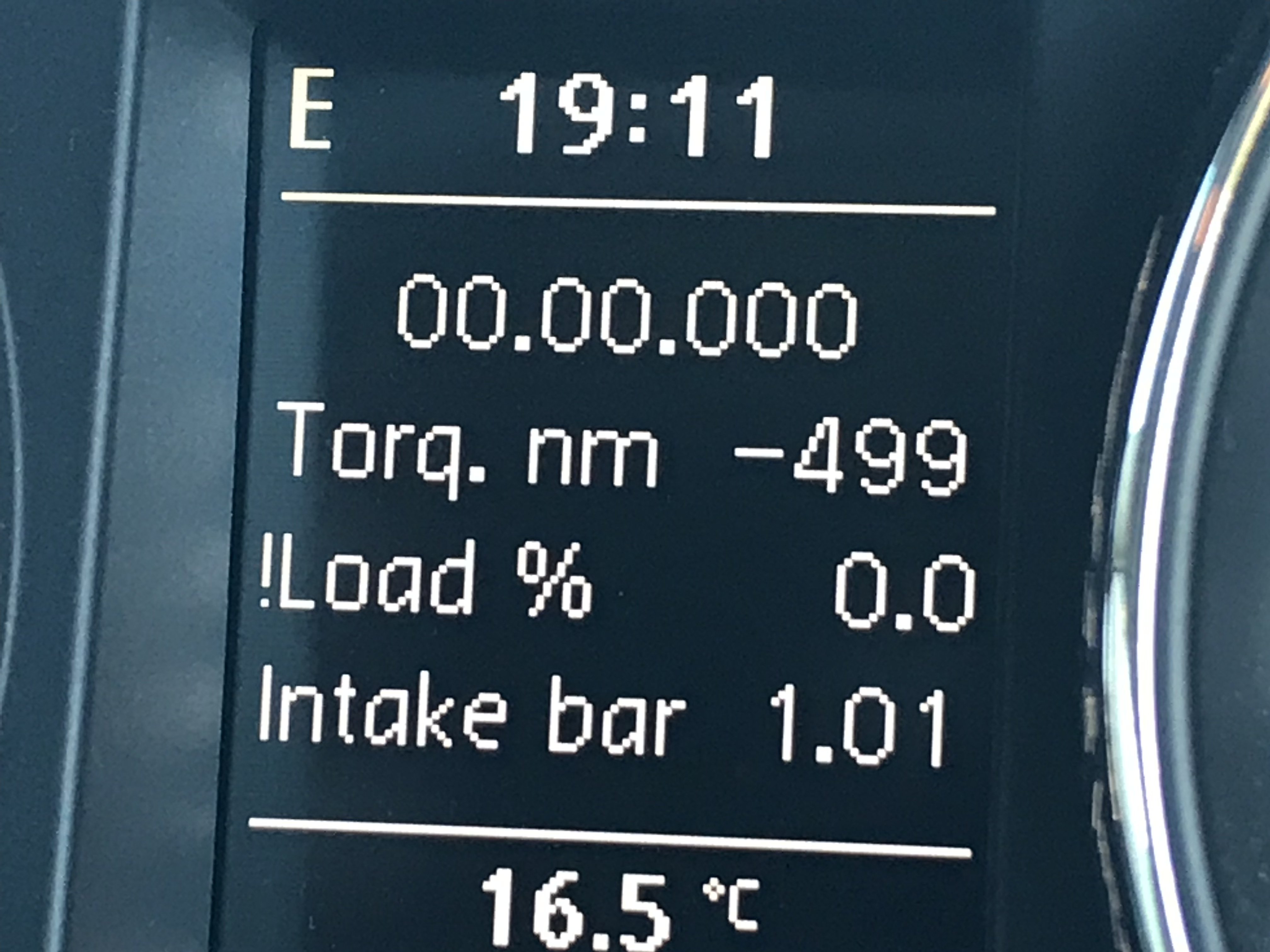

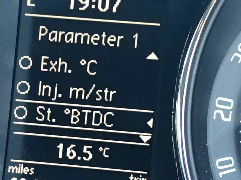

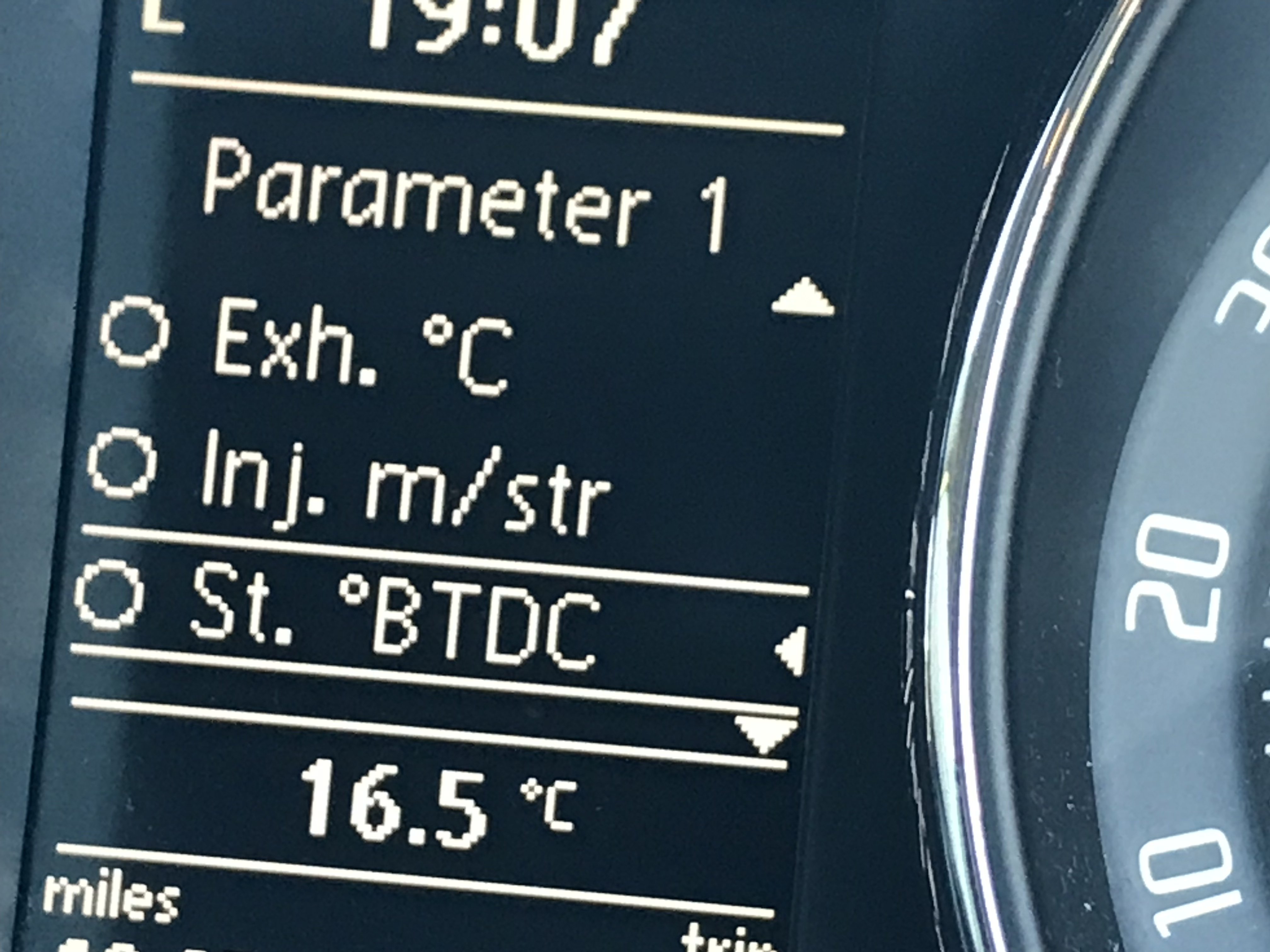

My car is a manual but I did see something for DSG in the list when setting up and selecting the ones I wanted.
When I get home I will have a look and post a pic.

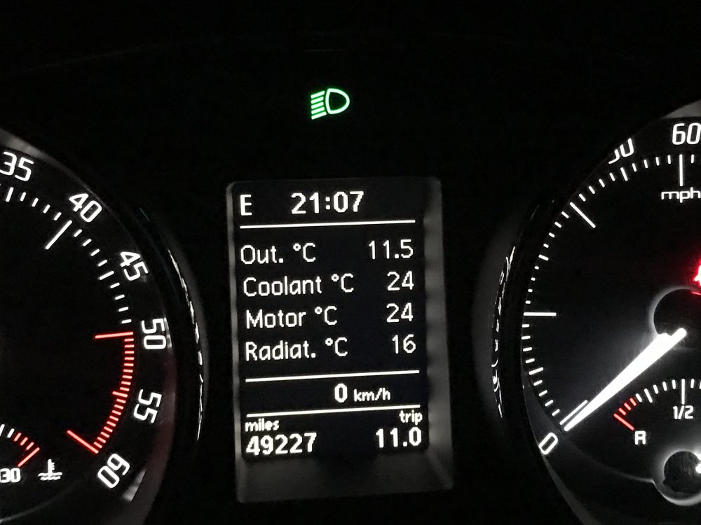

Just checked, it only shows DSG Nm not oil, but they should be able to add it on a firmware update if they can capture radiator output temp (to see when thermostat opens)

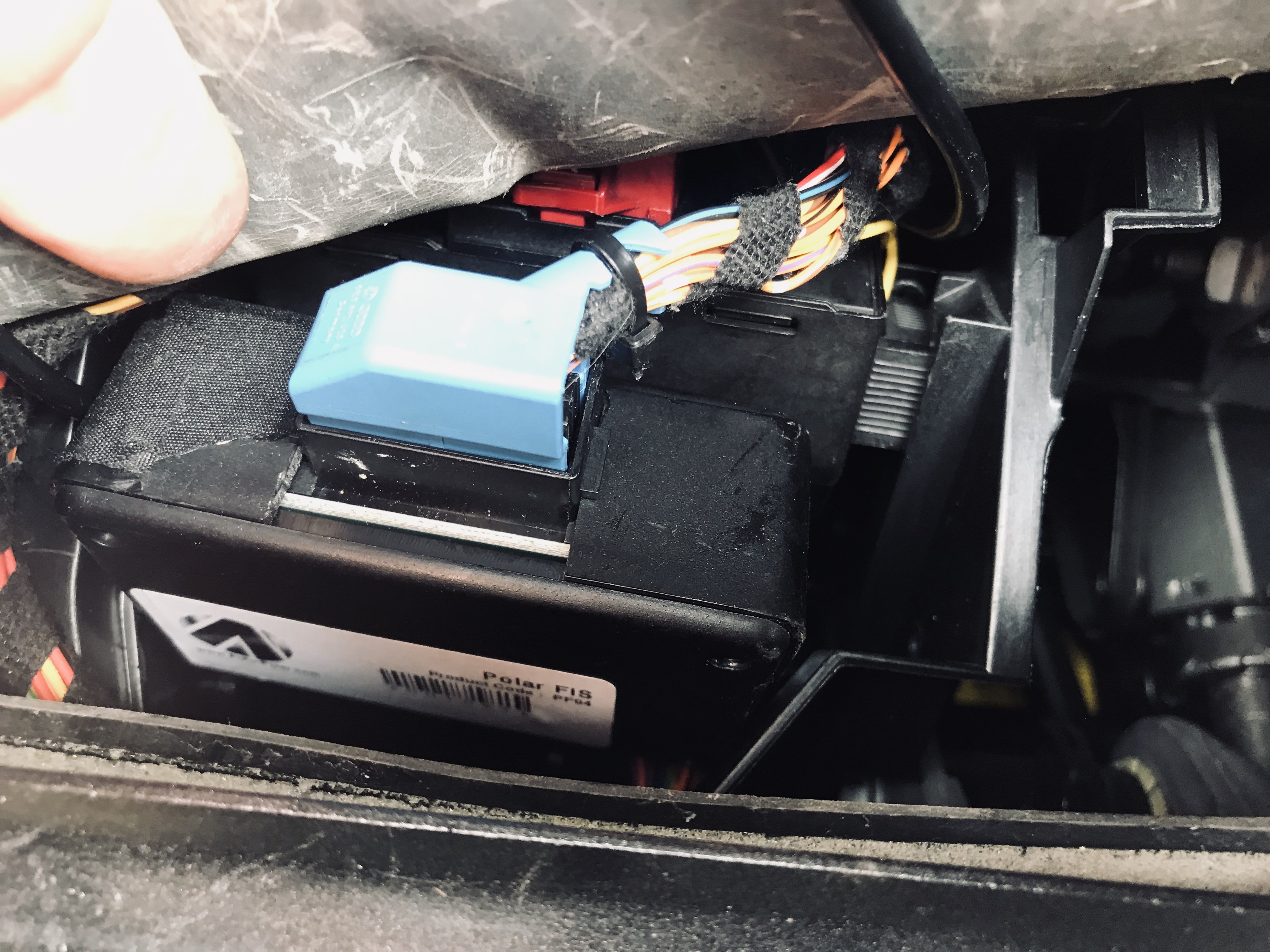

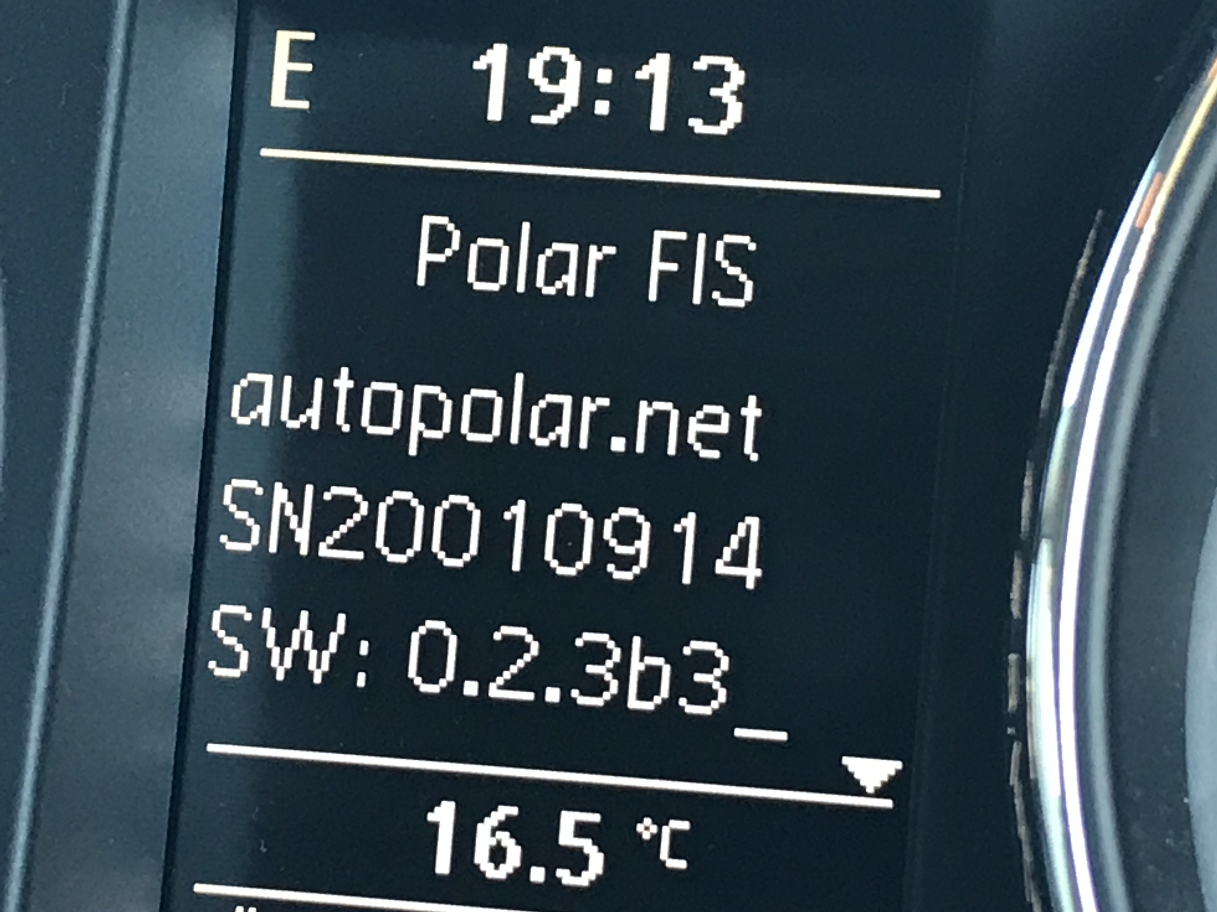

If you fit one, best tip is to fit and tape a usb cable to the unit so you can update the firmware. They have released two since I’ve had it, wiper motor frame has to be removed to gain access to gateway, easy to do, but a PITA.
I fed the cable to the SC fuse box area, makes life easier.
