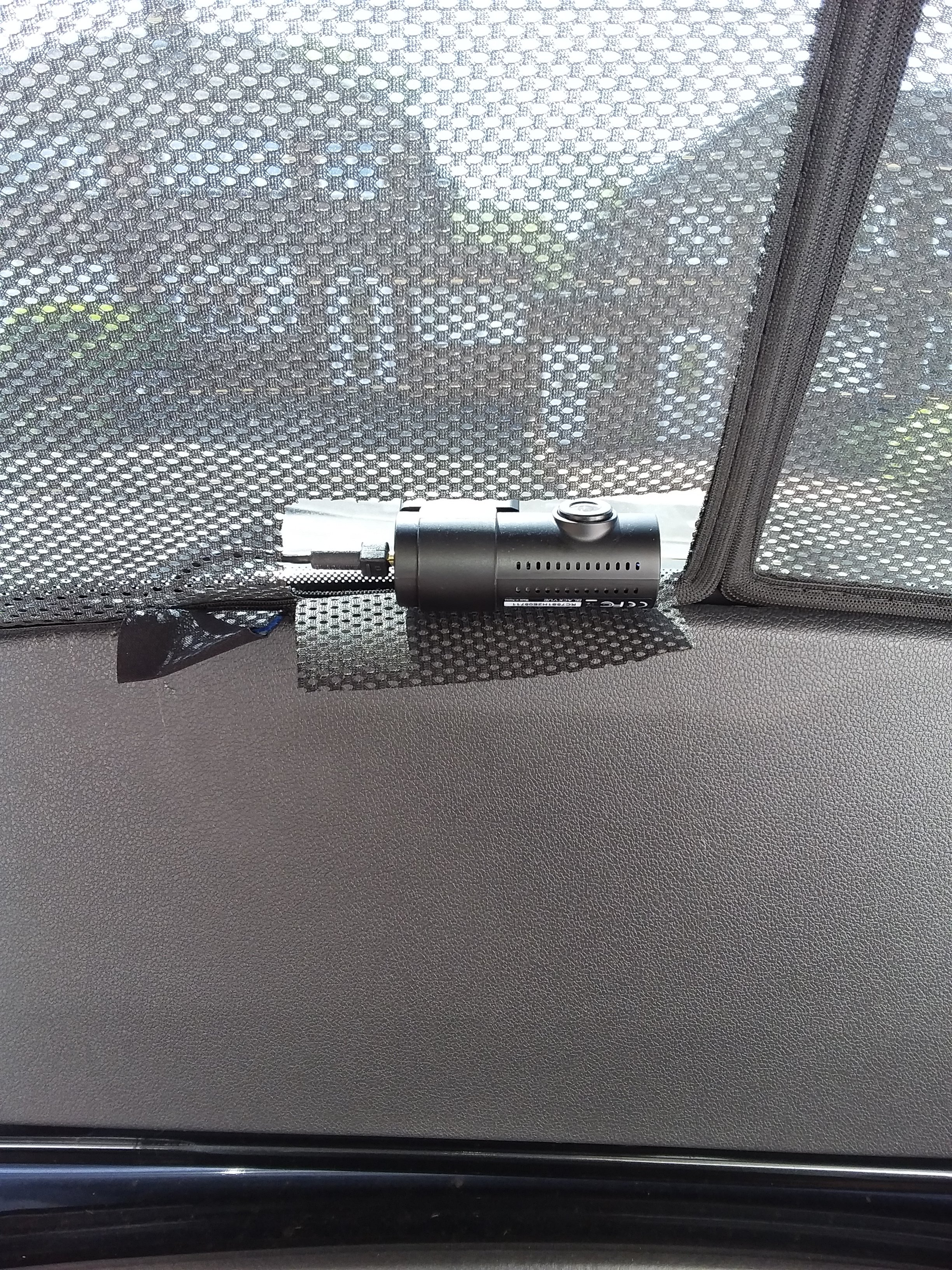

I've also got car shades and I got a sharp blade and cut a flap just big enough to go over the rear camera (BlackVue).
The only issue I have is that the combination of taking the tailgate trim off a couple of times and the cable to the rear camera the trim to glass gap is now larger than factory and the clips work their way out. Carshades sent me some longer ones which helped.

I've got the factory privacy glass which isn't that dark, the BlackVue has no issue with the tint. We got the blinds for the dogs and Mrs Cakemonster is a triathlete and if the dogs aren't in the boot a £3k time trial bike is.
It's quite discreet from the outside, to the point I've considered a naff sticker to ward off tailgaters
I’m the same I have factory tint buts it’s not dark so the car shades make things better.
