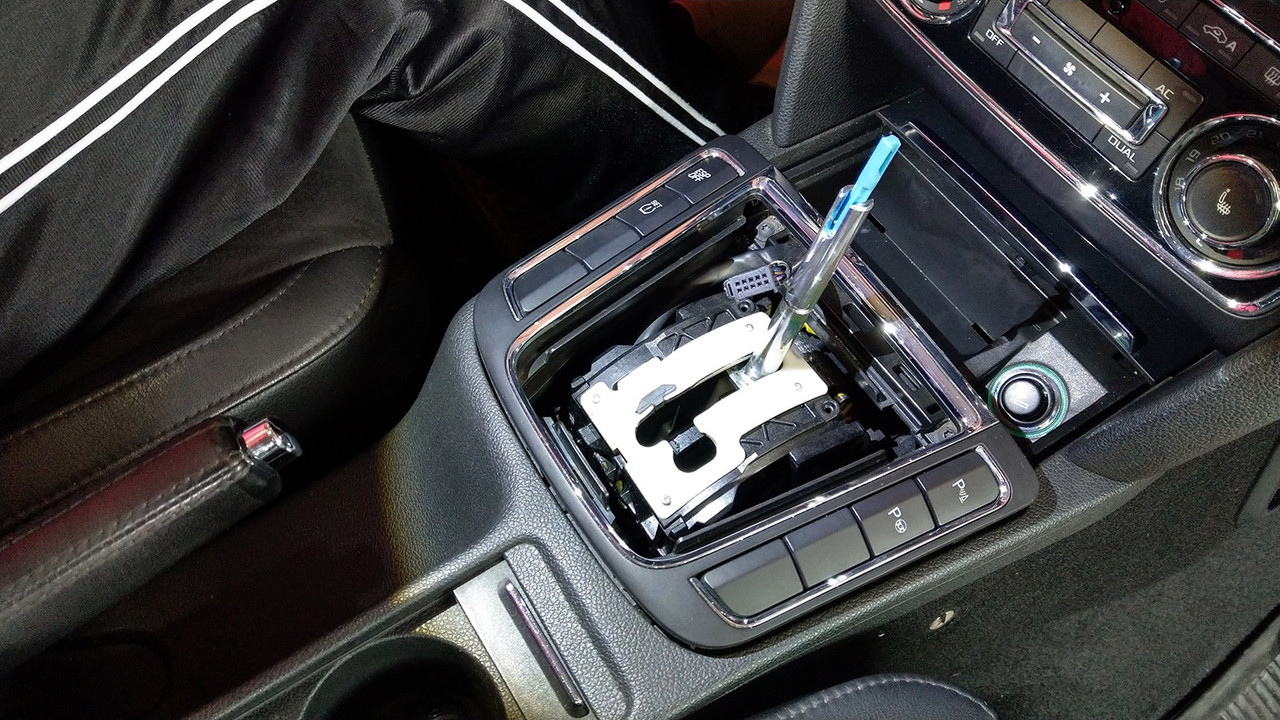

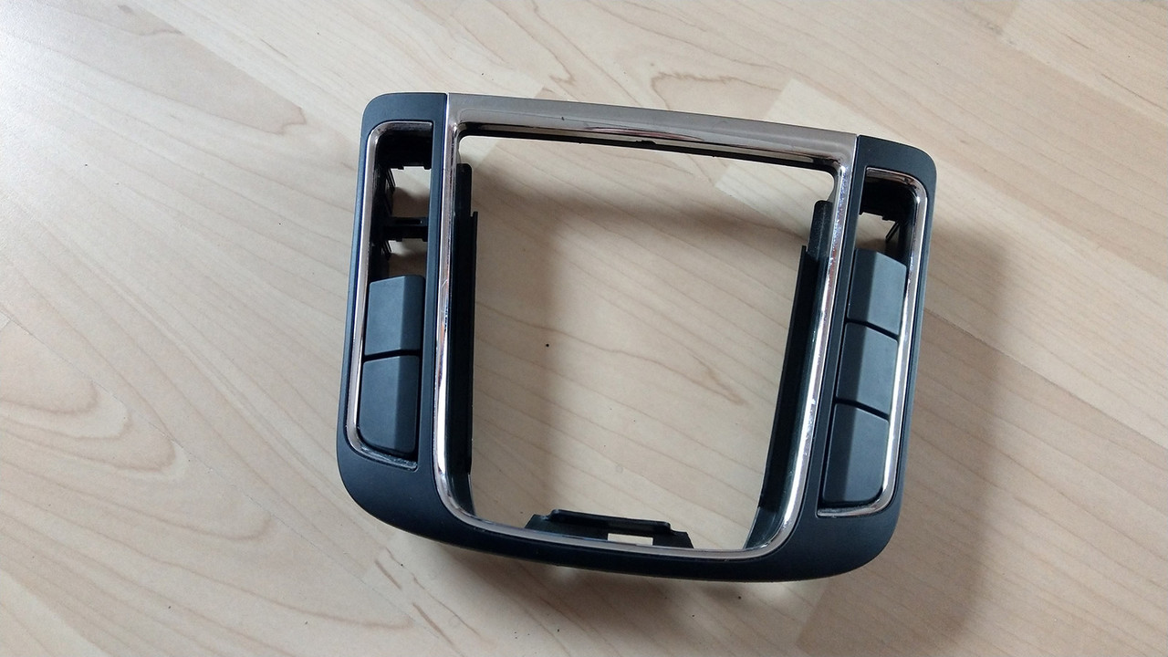

The "new" trim piece

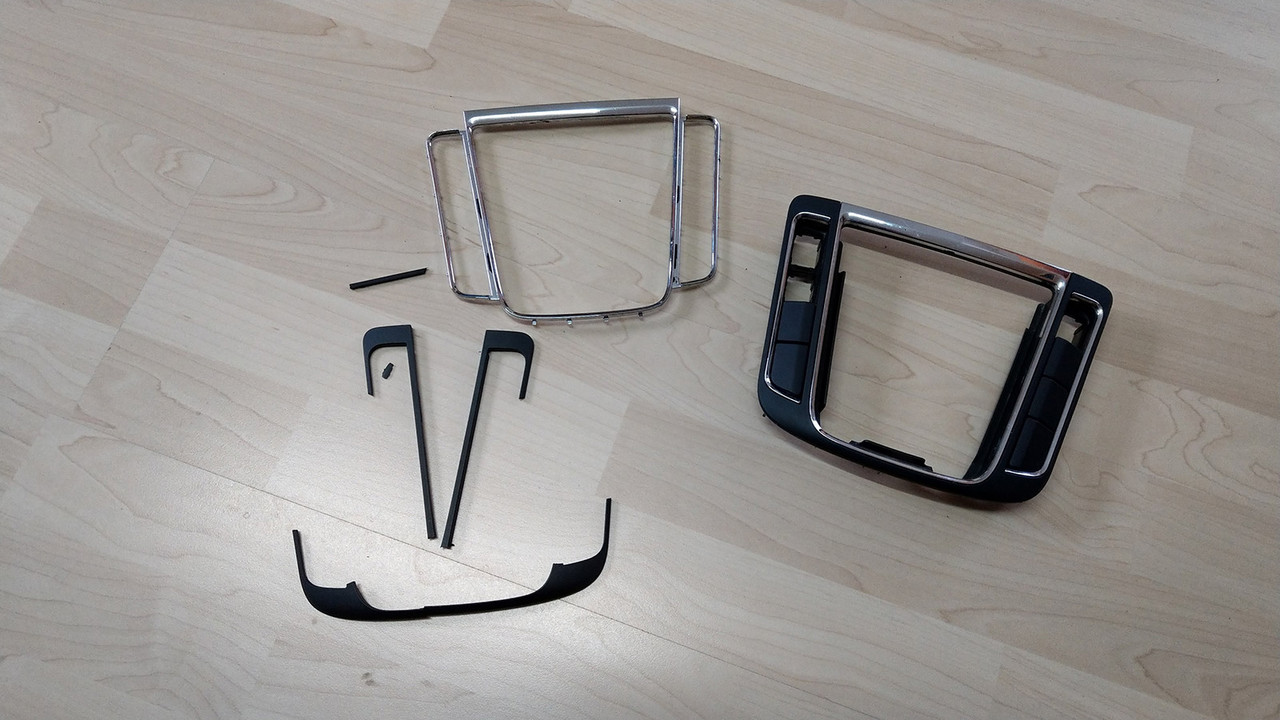

At this point, I've already deliberately broke pieces of the old trim in an attempt to recover the chrome part
The chrome part survived from the old trim, but can't be easily swapped to the 2nd trim piece (without breaking something)

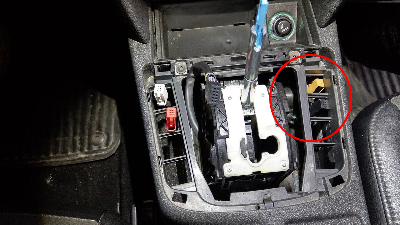

My car is equipped with a gearbox cylinder lock device, and when it was installed who knows when, the cables were put below it, instead of under it (red circle), meaning I had much more room to maneuver making it much more difficult to unhook the cables from the connectors and then connecting them back

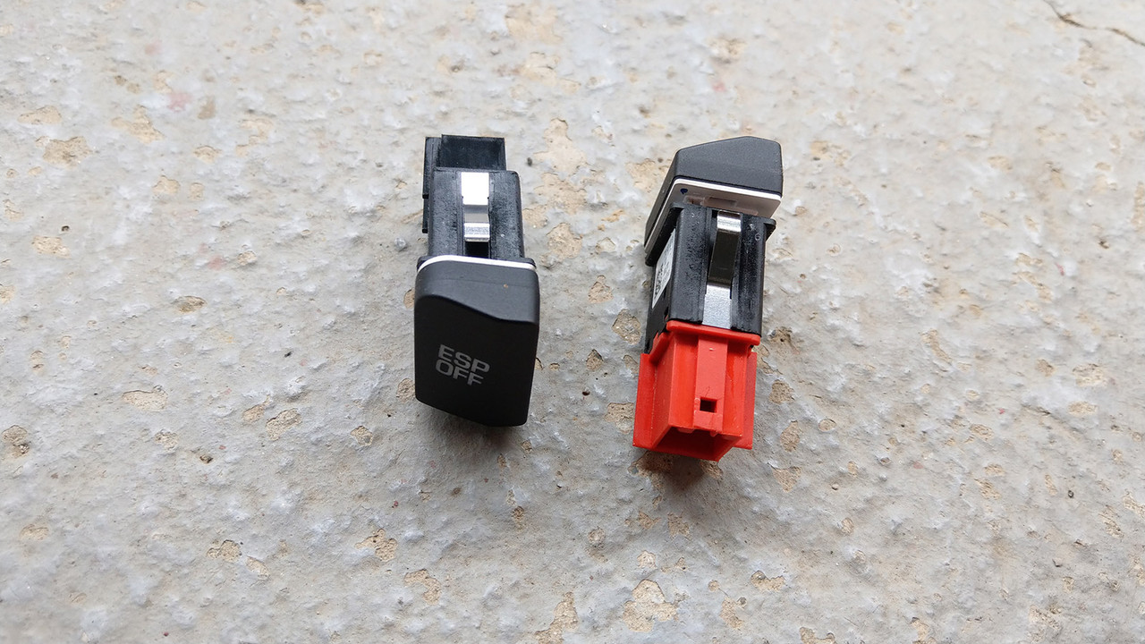

How the buttons look like (4 different colors, the bottom connector parts)

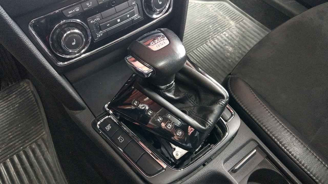

Nearly done, this "new" trim looks much better, at least it has no cracks on it
The whole procedure took me some 30 minutes (already knew how to remove the gearshift lever from before)
Obviously I meant "instead of above it" ... 😂
