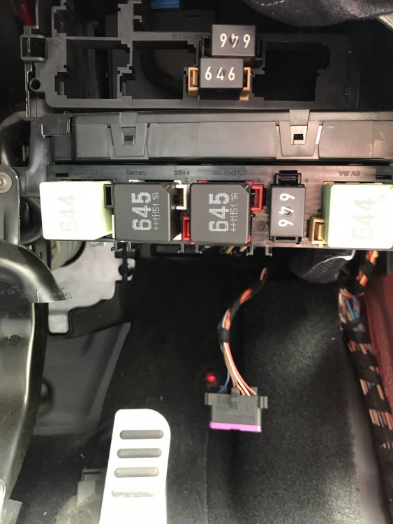

Right I’ve pulled the white/yellow fuse thing on the left and put it back in . I’ve tried a 20amp fuse should be 30amp but haven’t got one and it didn’t spark . Tried the rear windows and only the drivers rear worked . The passanger side didn’t . I’ve really done nothing to make it work apart from pulled that fuse type out and back in

The white/yellow thing on the left with 644 on it is a relay, not a fuse.

Do relays fail ? Didn’t really move any wires . Not to make a difference I don’t think . The internal fuse box holder isn’t live anymore . The  passenger rear window just clicks now when you try and use it from the drivers switch and the door switch . Could this be the motor itself that’s not working for it to do this
Relays certainly can fail but I doubt it's related. Both the fuses I mentioned earlier are connected to terminal 30 which should be direct from the battery, possibly via fuse SB29 (50a).

Relays do fail, usually by failing to operate (which can produce a "click" with no action as you are experiencing) or less commonly by fusing in the "on" position which means you can't turn off what you're trying to control (doesn't sound like what's happening for you).
You can test relays with a resistance meter which can tell you whether the contacts are open when they're meant to be and - if you have the technical spec to hand - you can measure the resistance of the actuating coil to determine it's health.  If you don't have such facilities available just buy a replacement from your chosen auto-electrical supplier; relays don't cost much and it's usually worth having a spare on the shelf rather like your spare fuses.
Having said all that, just getting a click when you operate the switch could also mean the relay is actuating correctly (the "click") but whatever it's trying to enable downstream isn't working.  Window motors tend to work or not, and other failure areas include connectors (again!) and the window regulator mechanism which is usually driven by a piece of wire like your Granny used to use to hang her window mesh.  They can and do fail and aren't repairable.
