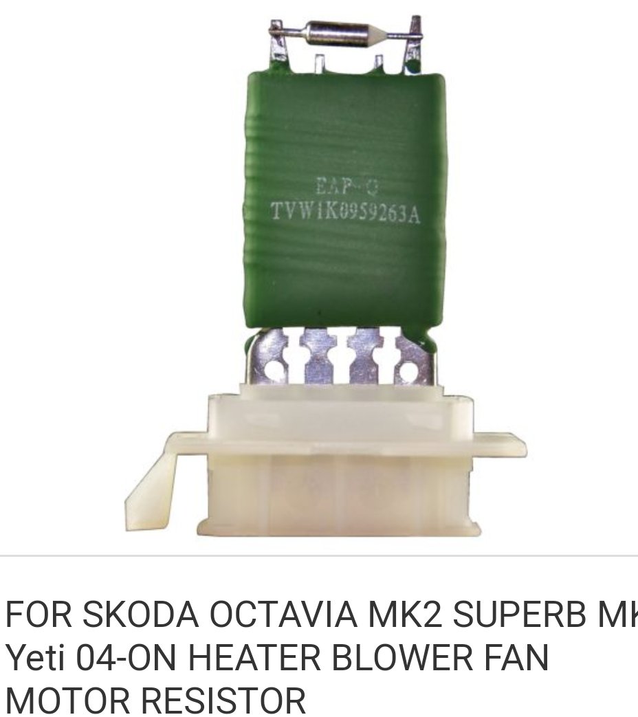

So hopefully this is all you need, cheap easy fix, under the glove compartment in the passenger footwell.. just give us a little more info.. like if it's just the blower control and only the highest blow power works then nearly 100% sure this is your issue. Keep us updated.

Hi thanks for reply there is nothing to the control panel at all can't turn from hot to cold even the de mister has nothing
It doesn't blow on any setting there is not even the wee green light wen u change from window blow to feet blow
