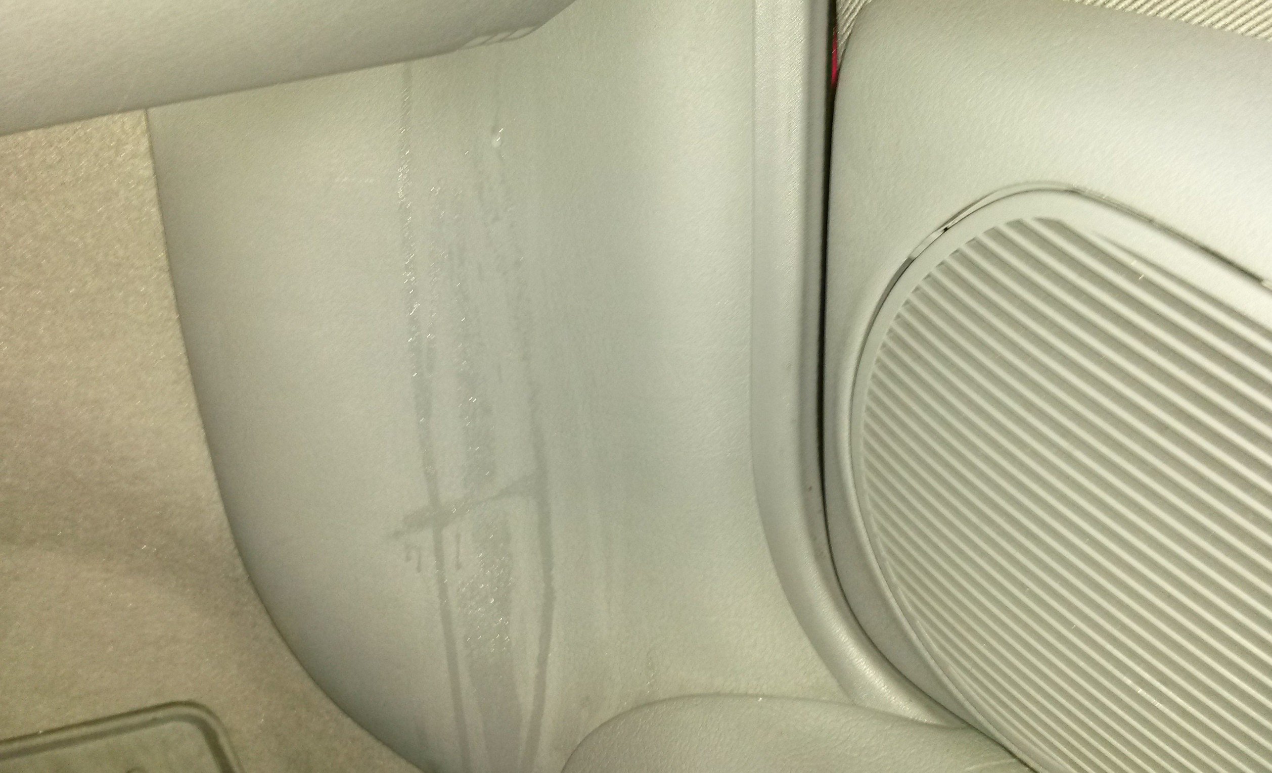

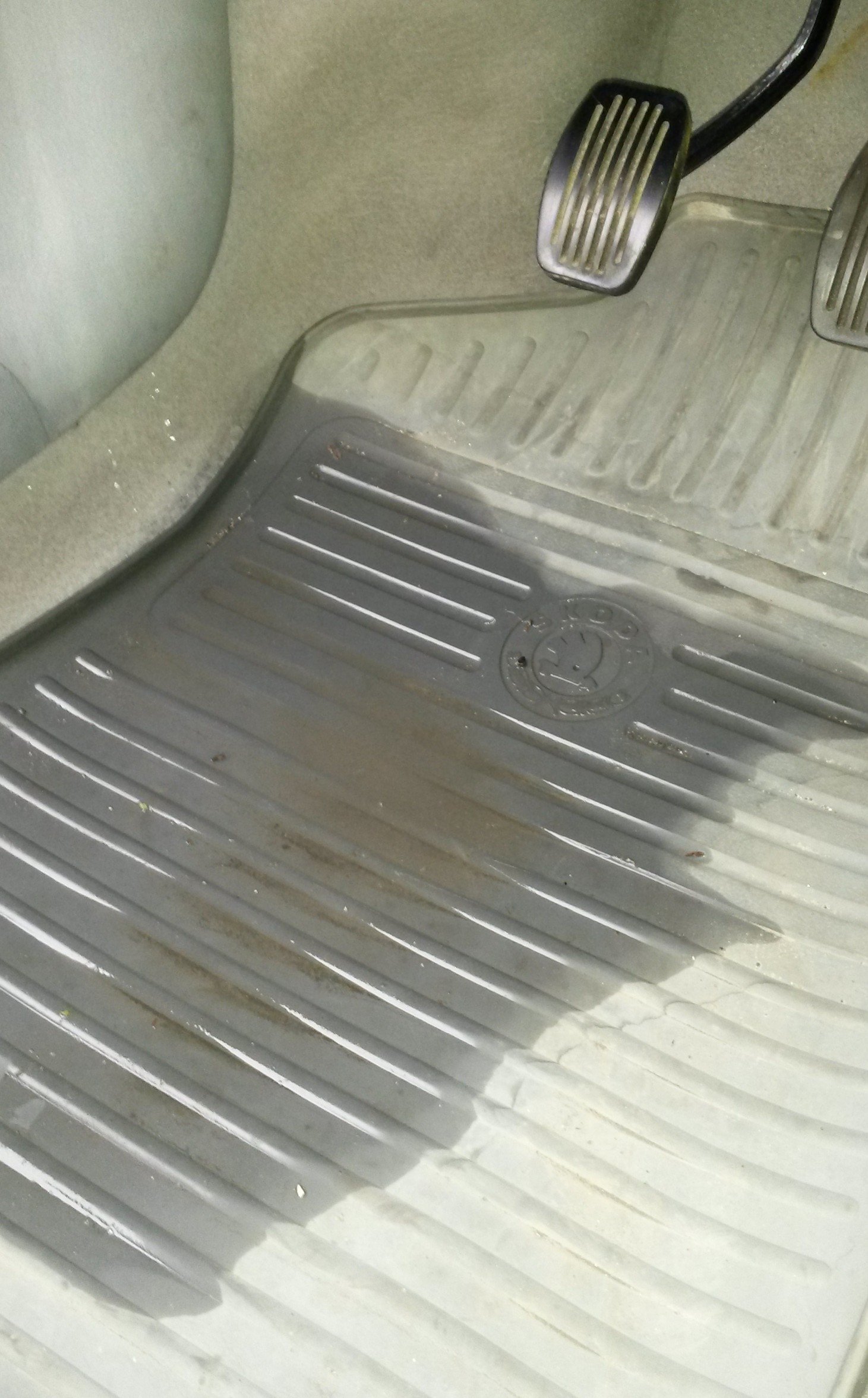

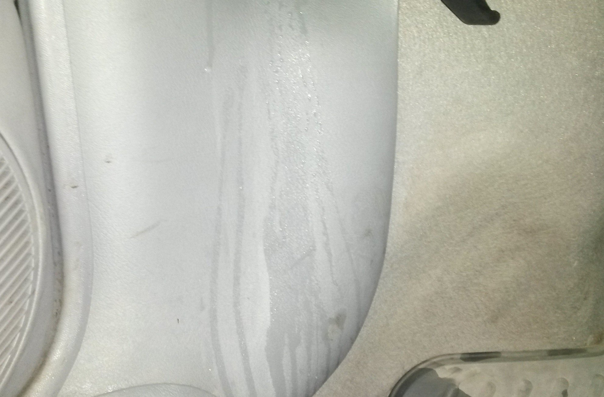

Hi all,
After I bought my old lady a couple of weeks ago I need to comfort her.
After 20 years of duty she lost many good friends.
After around 2000km the last month, the first time in "heavy" rainy weather I felt her tears
dropping in my left shoe.
My last Felicia has the same issue.
The problem is at the left and right side.
Is there a "standard", "weak",  "rubber" problem in an old  Felicia which is a well known issue, to look after,  to keep my feets dry?
Thanks.
/Maba
It is a bad windscreen seal and corrosion underneath.
Hi Ricardo,
Today I removed the window wipers and the plastic cover and  had a look at the windscreen seal.
I can't see any corrosion underneath but it looks like there are small gaps at the left and right bottom corners of the seal and the body.
It simply doesn't seal anymore underneath and reached the end of life cycle.
First a try with silicone otherwise a new seal....
