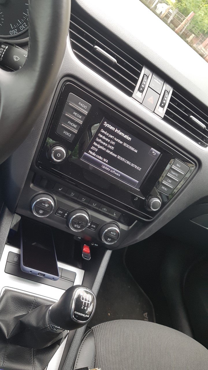

So, I have this unit. thumbnail_20190514_092211.thumb.jpg.9e186277162542761d295b15fc11cfd3.jpg
Also a MIB1 and as above the Drive Green menu cannot be activated on the MIB1. I have it on my car and I never look at it, I really wouldn’t worry about not having it, you aren’t missing out.
