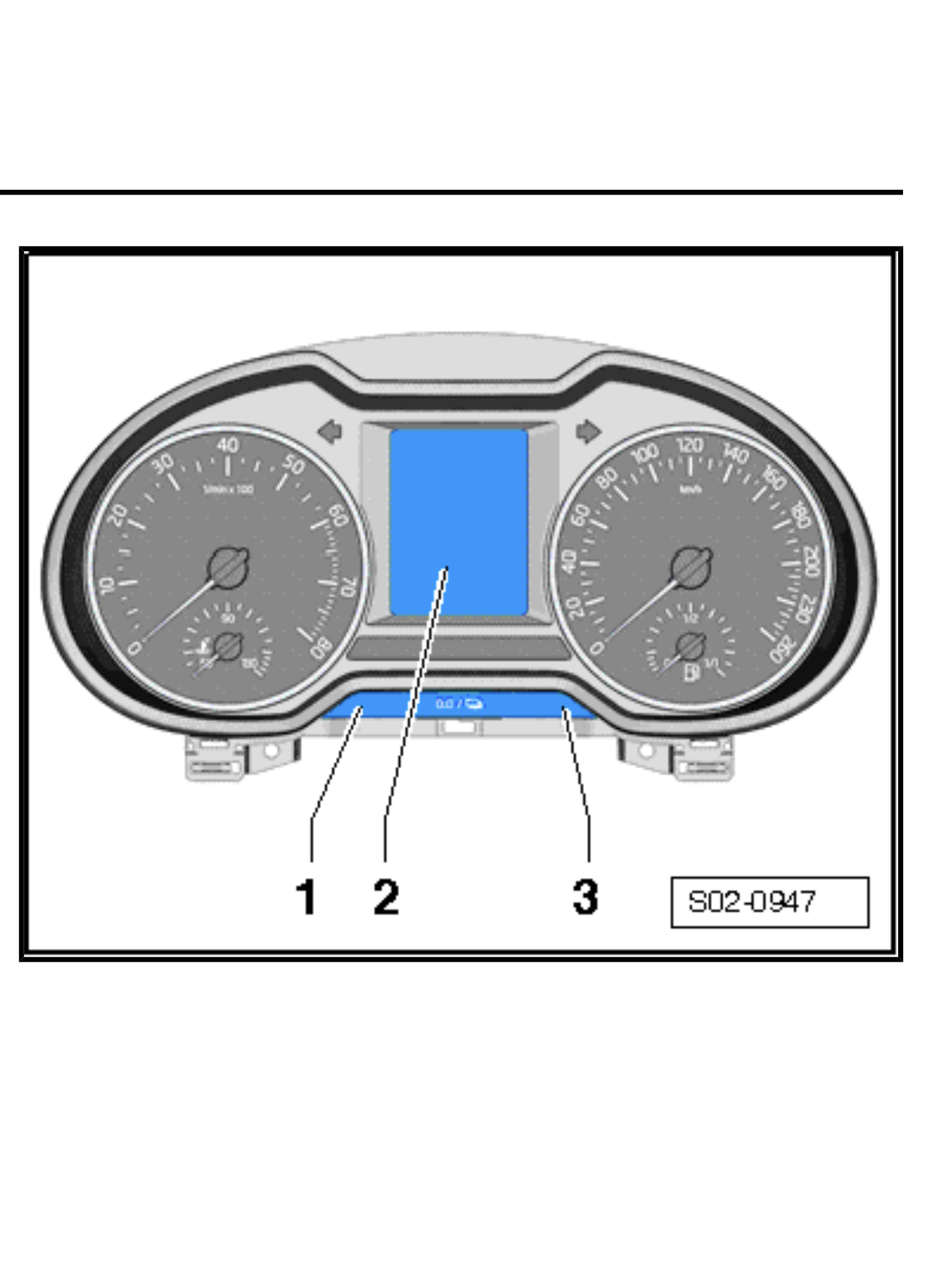

1. Switch off ignition
2. Press the right hand side of the trip reset button (button 3 in the attached picture).
3. Holding that button down, simultaneously turn on the ignition, hold button until “DELETE INSPECTION ? “appears in the display.
4. Release the button 3
5. Press the button 3 again and the inspection message should be reset.
Try this, works for me.

Hi.
Oil change and inspection are two different things.
you can only clear oil change by the buttons and inspection needs to be clear using the diagnostic tools.
That's because oil and service have different intervals.
If you set up identical intervals for both of them (using ex. Delphi) then you can clear both using the buttons on the dashboard.
