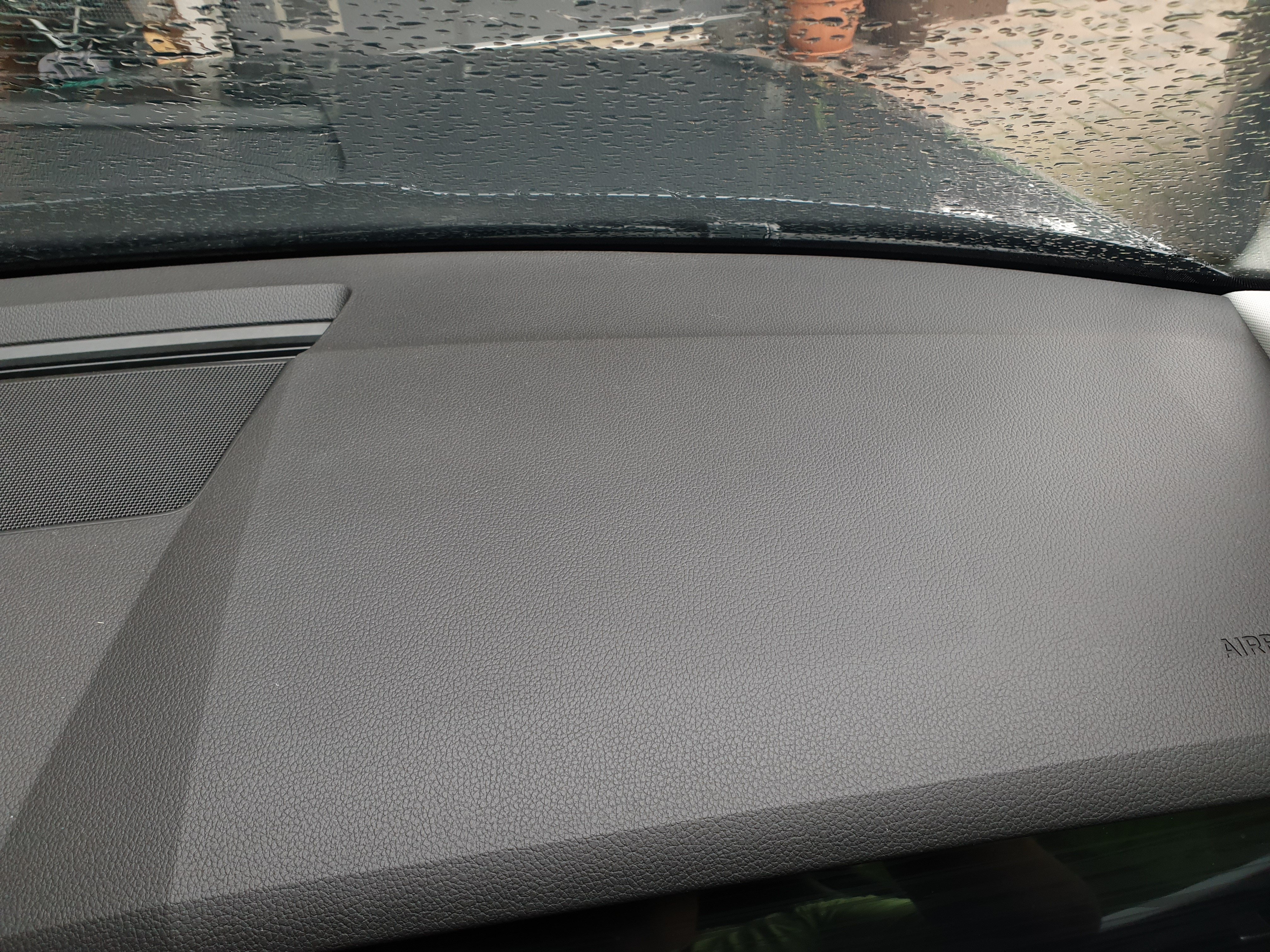

Hi all,
I noticed by my Kodiaq a strange marks to appear on the top of the dashboard after 1 year since I own my Kodiaq car, so I wonder if someone can help me understand what those strange marks are and if this happened to someone else and what the cause of this is? How did you solve this issue (warranty repair - replacement) and if this is defect? It's like a U shape mark on the passanger side of dashboard. It first looks like someone put something on it but this appeared on its own after 1 year. Thank you for help.

Looks like the indent for the airbag. The indent shouldn’t be visible like that though.
How can this be solved then? Change of motherboard under warranty?
The plastic is purposely thin there, so that in a crash, the airbag will rip through the plastic, then inflate and try to save the passenger.
it isn’t normal that you can see the thin area, though.  You can try requesting a new dashboard top under warranty, but I can't see how any motherboard is involved.
We had the same on our 1.5TSI Karoq. Skoda admitted it was a fault eventually and replaced the dashboard under warranty.
I would see if you can live with it, just imagine the idiots at your local Skoda dealer ripping out your dash and badly fitting a new one, there will be marks on all the trim and it will rattle like mad forever.
It looks identical to mine, perfectly normal. As mentioned its where the passenger airbag deploys from.
Even if it wasn't normal, I agree as per above, having my local Skoda dealer attempt to replace the entire dashboard would 100% result in more marks, scuffs, rattles and overall dissatisfaction compared to the very faint outline that is there at present.
So what was mentioned above is that in this case it’s better to leave it as it is instead of getting dashboard replaced? Might first stop by dealer, so they take a look at this issue and then will see what they suggest as so far they solved 2 small issues with the car perfectly. Thank you all for the info. I hope this gets solved, but its not something that would make me love to use and love my car more.

I wasn't at the dealer yet, but will stop by them in the upcoming week or so to see what they say about it. I was able to minimize the marks of this airbag thing with special dashboard wiles from Armorall that delivers more mat finish to the dash so its not noticable that much now but still for the price you pay this should be addressed to Skoda dealer anyway. Will see what they will say. Will reply back here once I get their opinion on this.
