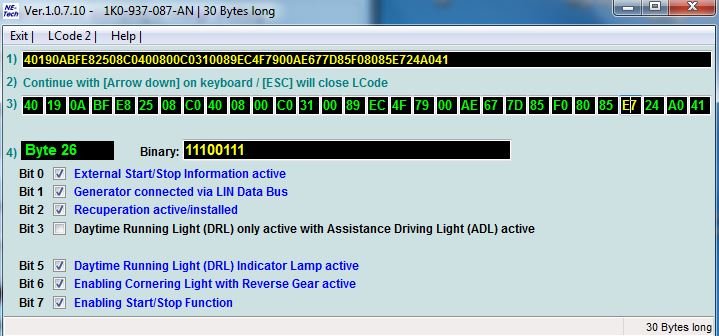

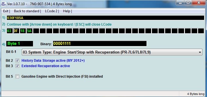

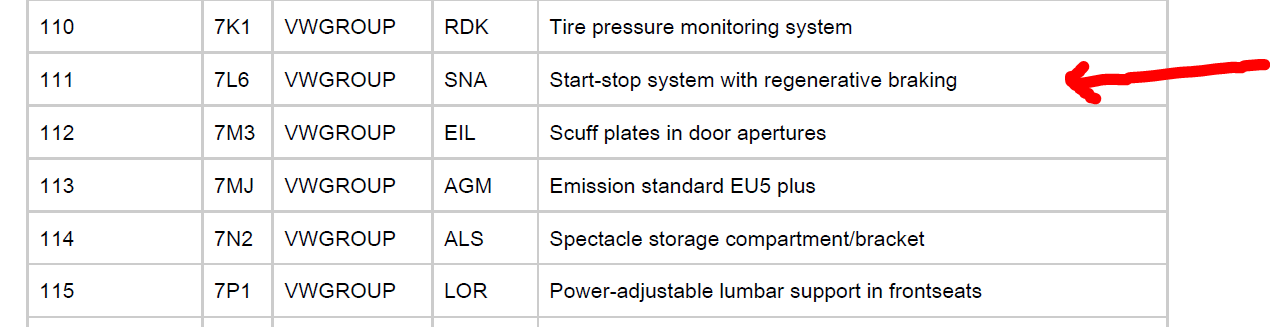

Is there any solution to this ? Is it the recuperation that demands this aggressive engine braking ? Can it be disabled via vcds ?
So far i have tried to remove the marking from recuperation of energy, and i have tried removing the cable on the AGM battery frem the battery control unit, but it still brakes very agressive at low speeds. Any thoughts ?
