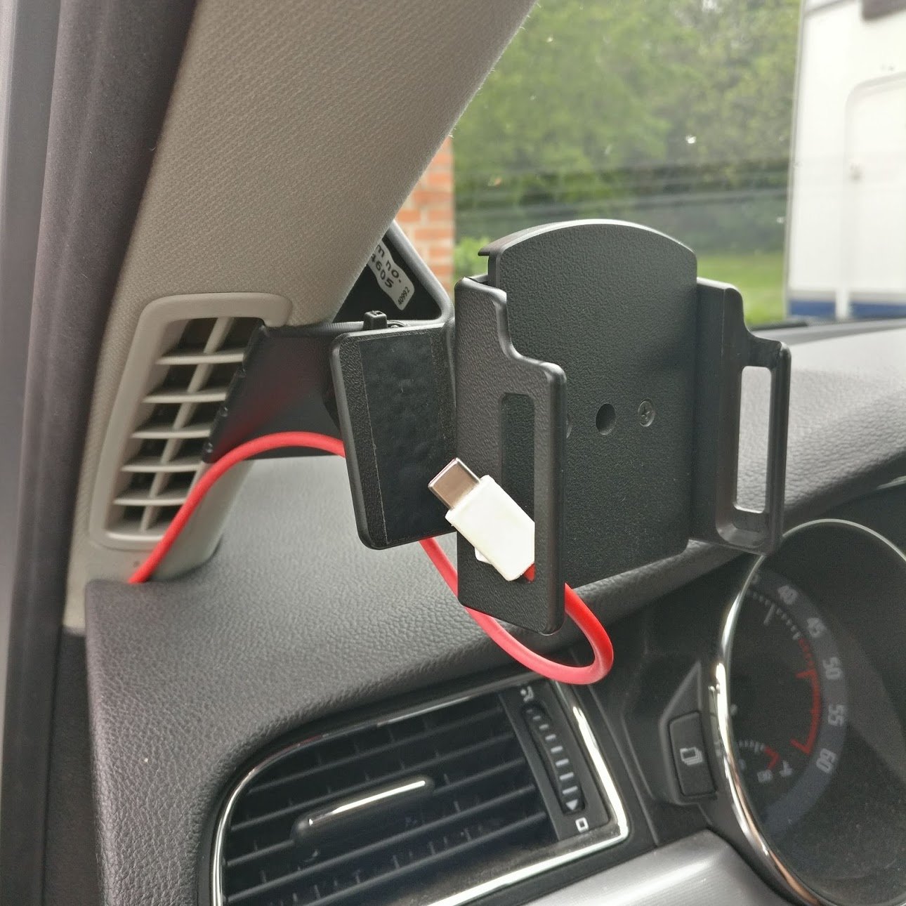

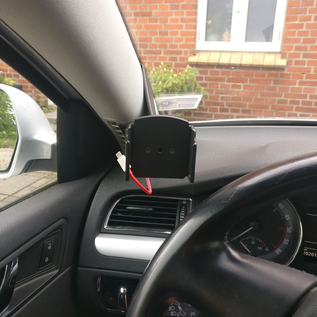

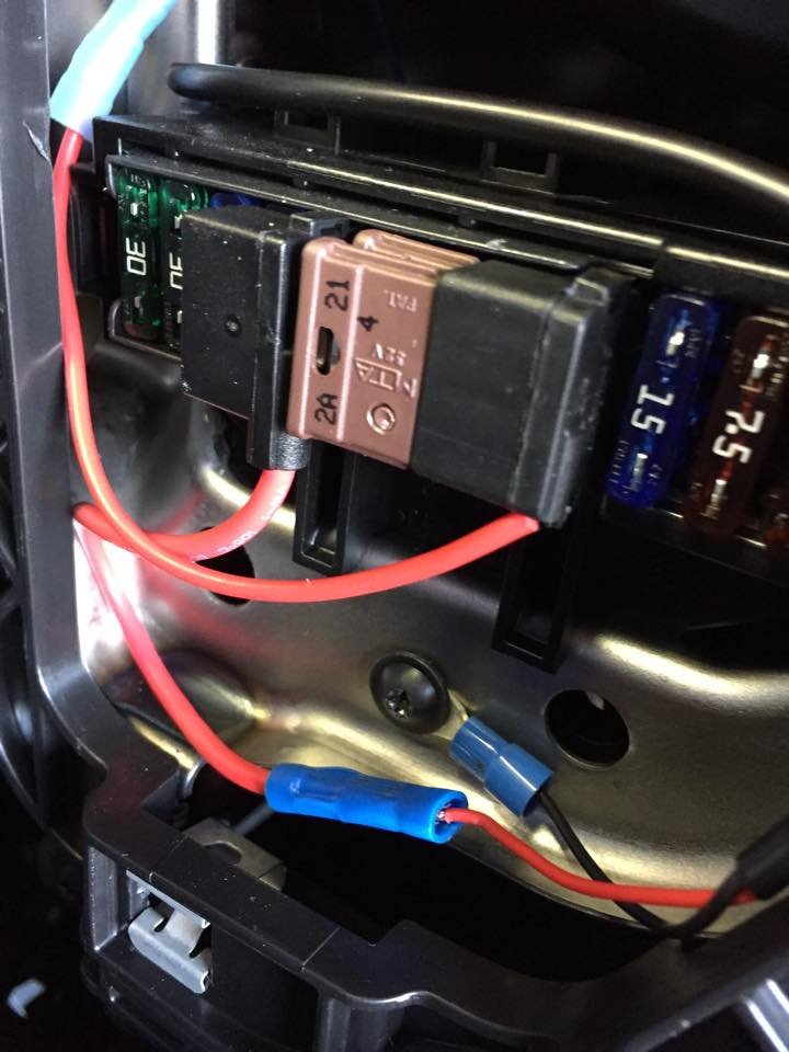

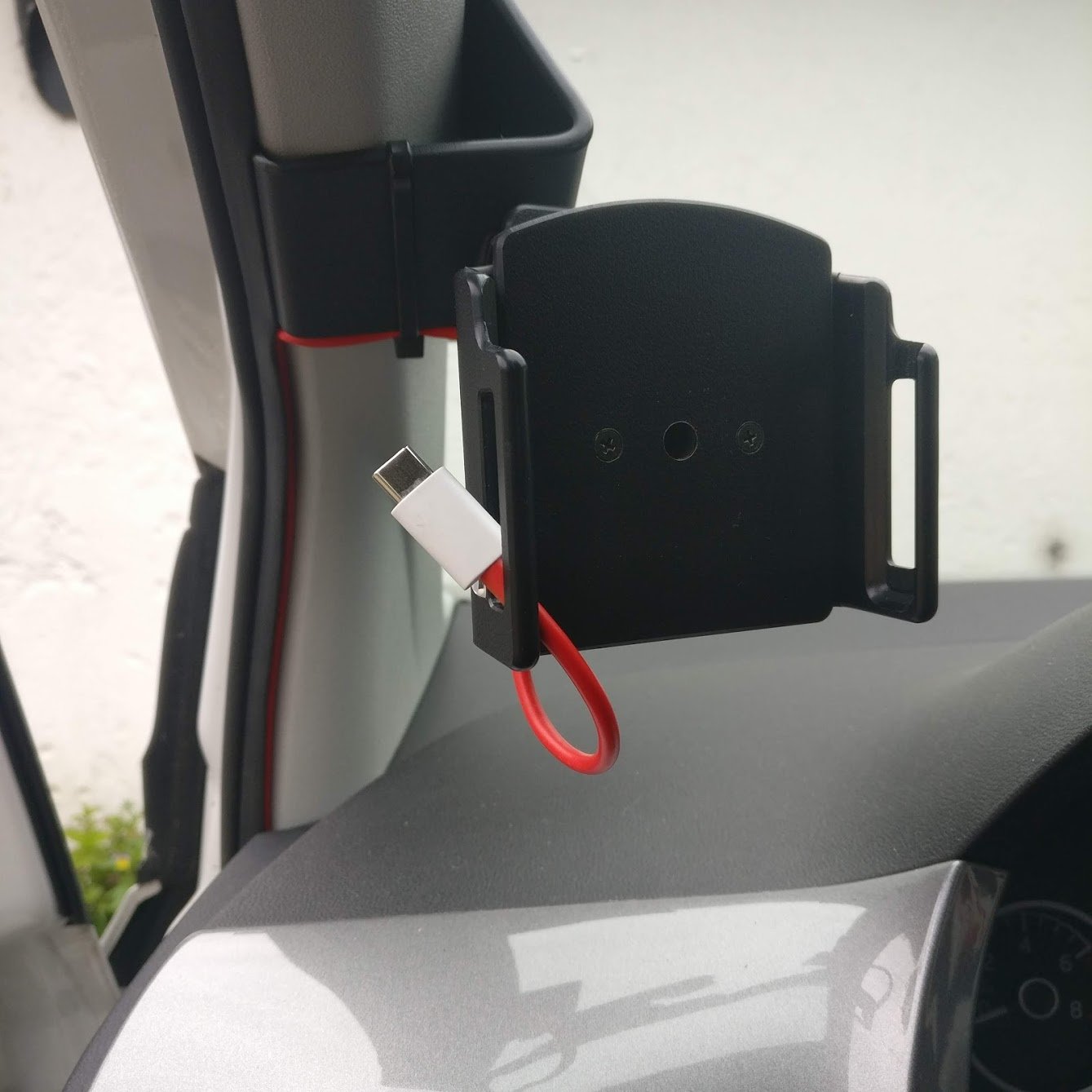

On my previous cars i've only had to consider charging. The first 3 pictures are from the Citigo and the last one from the Superb. From the drivers seat they cables are almost hidden away. The power is just drawn with a piggyback fuse.

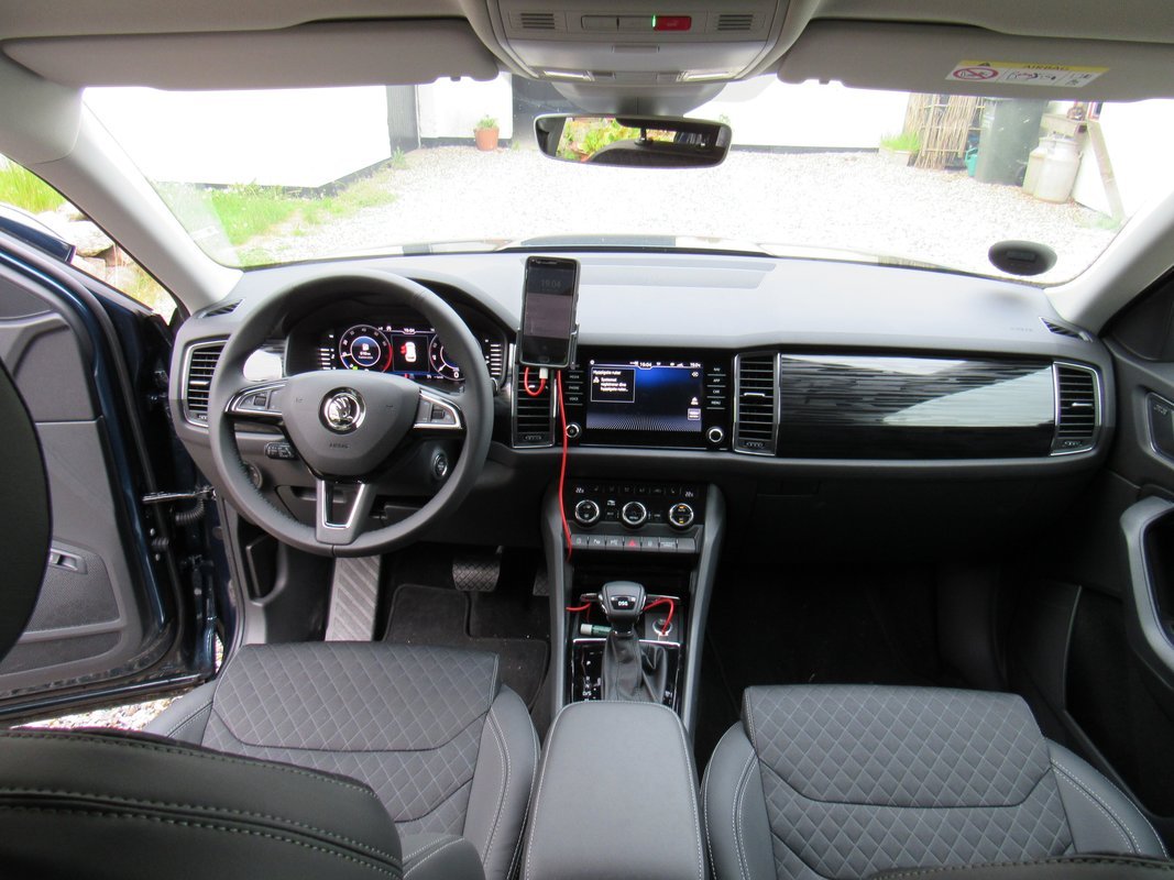

Last is the Kodiaq with the phone in a center holder.  It blocks some of the buttons and the corner of the screen. Especially for my wife. I also prefer the corner position as in previouss.
