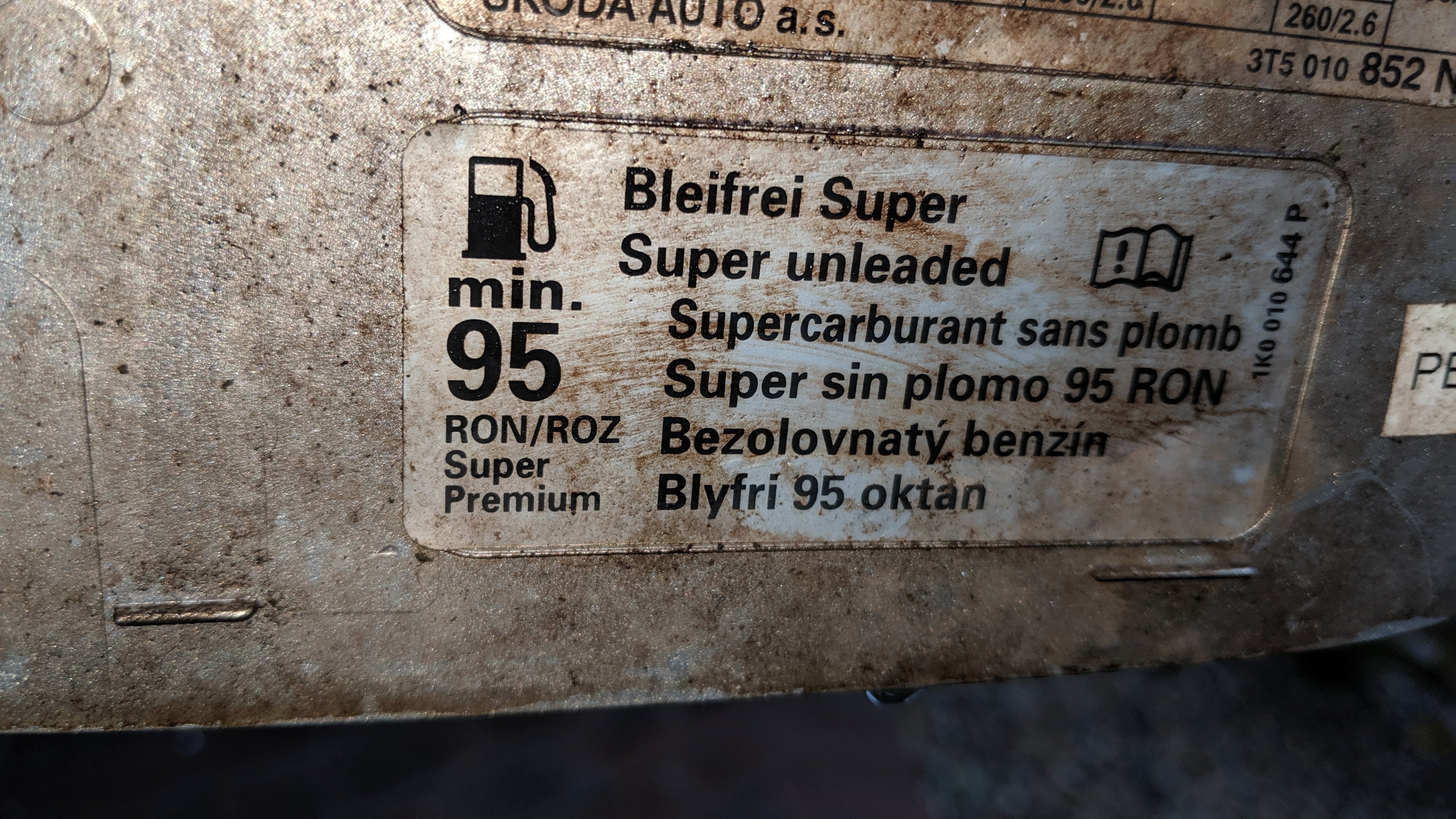

Mk2 Fabia vRS 1.4 TSI have 98 ron as the recommended petrol. (95 minimum)
TyrePressures_label.jpg.52937a330e6095b56c74a0d5d3eb9de0.jpg.c93a29b91d083884447cdf82b9ece445.jpg
