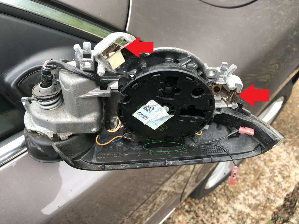

The mirror slides in these clips, try using plastic grease on the mirror tangs. You may also have water in the motors causing the binding, they just have plastic rack and pinion type movement, you could try putting plastic gear grease on these too, from Tamiya RC car kits etc.

Hey, 3T1704X4
How do you get in there? Should have been inside my passenger side mirror to find out why it wont stop when folding out, but I am afraid to start working on it.
Mirror glass out first then small torx bolts to separate covers. Careful with top as plastic tang easily bent if ham fisted.
