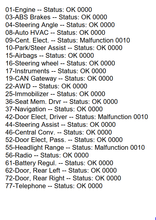

Below is te summary from the VCDS
The fault does not have to be engine related to result in limp-home mode.
To experience limp-home mode with no dash warning is extremely unusual.
Are you sure it is limp-home mode? Could the brakes be binding, could something have slid behind the accelerator peddle during the episode of hard braking?
What is the fault stored under 09-Central Electronics?

The central electronics issue related to an intermittent numberplate light!

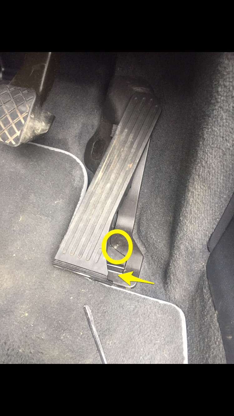

Thanks for al your help. I think the issue is accelerator related. I physically pulled up the accelerator as i did so it clicked like a ratchet and has been fine ever since. I think i will get the hoover out as there are a large number of little stones next to the accelerator hinge.

This is common with this type of throttle arrangement, the reason you won’t get any warning lights is the pedal won’t move beyond a certain point, the engine ecu just thinks that’s as much power you want, but you perceive it as limp mode as it won’t go any faster. True limp mode will have the coil light flashing on a diesel and EPC light on a petrol.
If anyone ever experiences an odd resistance on the throttle pedal, limited speed with no flashing lights.......PLEASE DONT FORCE THE PEDAL, the hinge is very thin plastic and will snap. One it snaps you will not even get above idle speed due to the pedal geometry and it pressing on the sensor.

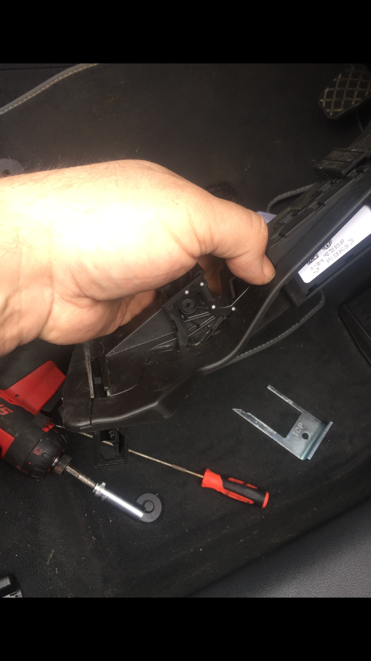

Best option is to initially flick out debris and hoover debris out, but ideally have the pedal removed (tool required for 2x lower clips)  and shaken to get rid of loose debris.
Had to replace 5x pedals in three months for this.

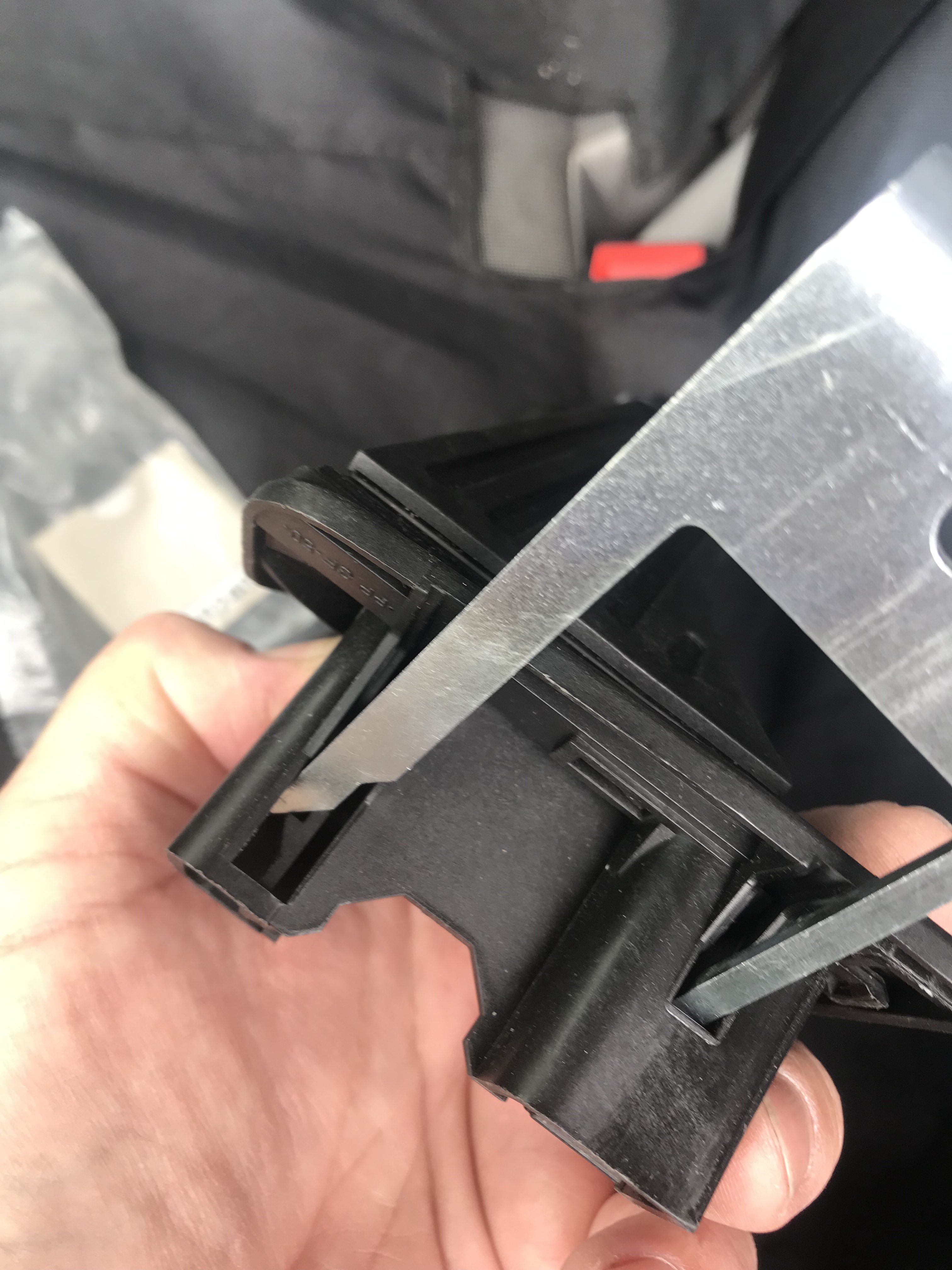

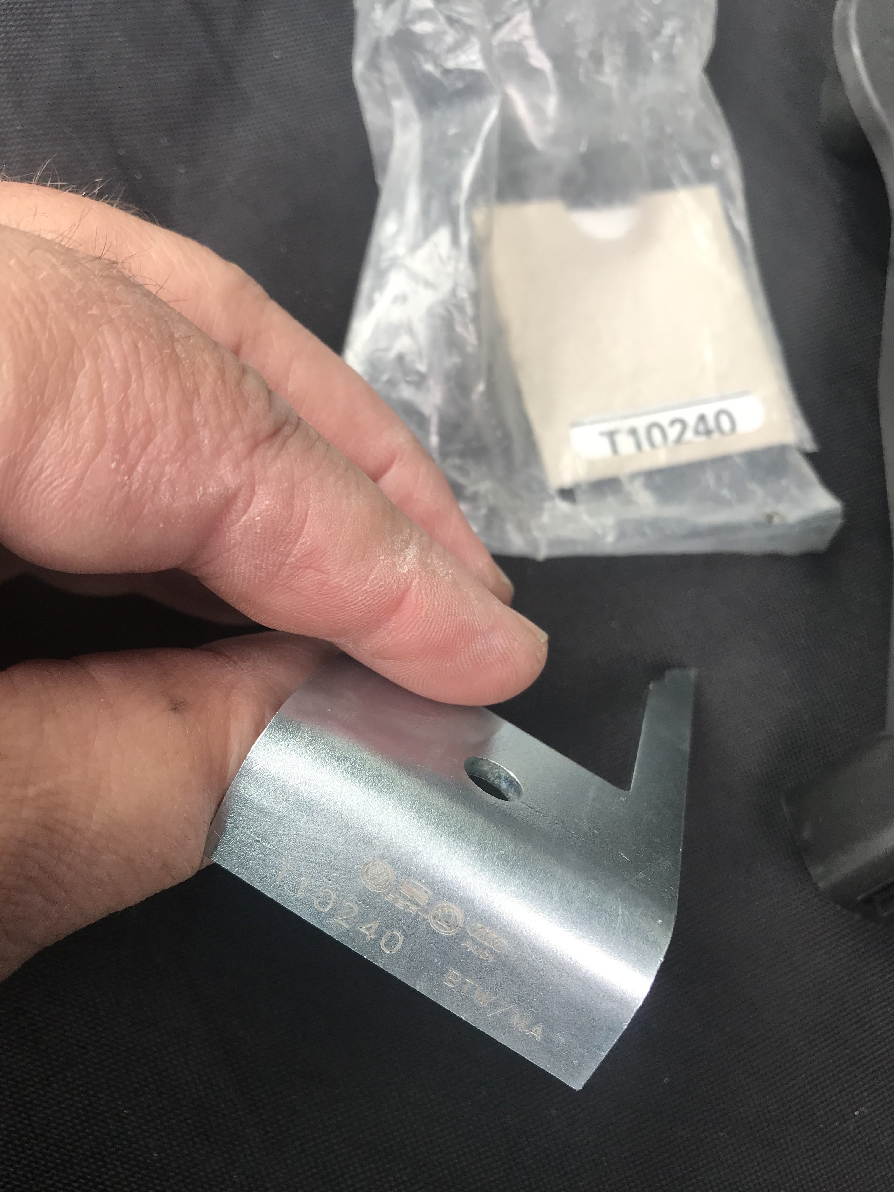

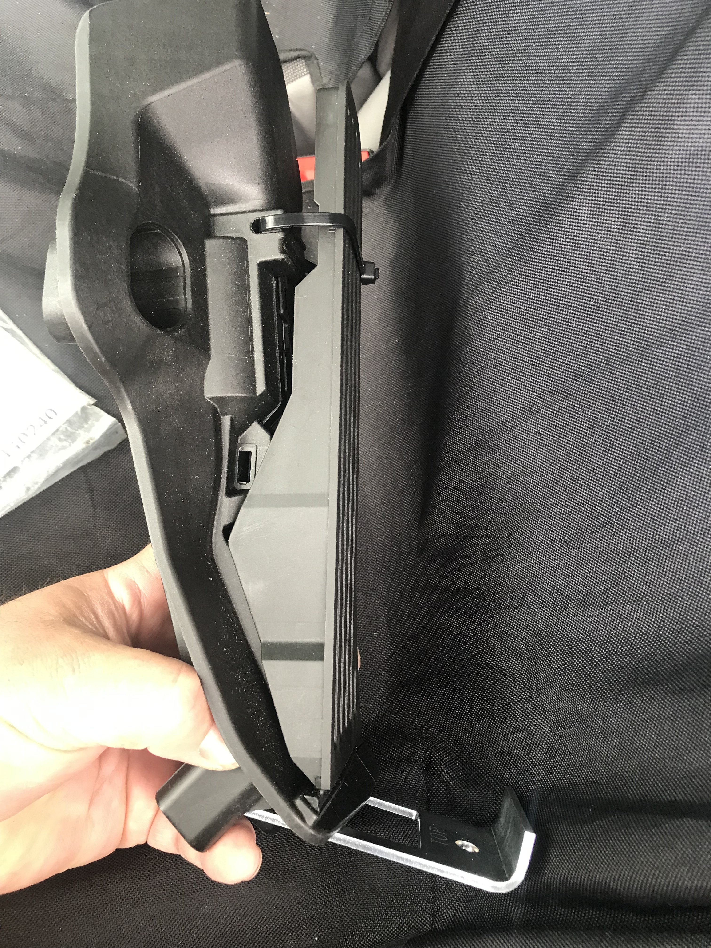

Top photo shows tool needed to unclip pedal, spike to remove cover for bolt and 10mm socket for the bolt.
The bottom photo shows the witness mark of where the stone was jammed under the pedal and the arrow shows the broken hinge.
The connector plug has a spring loaded release mechanism, no need for tools, just your thumb, please do not pull on the very small wires as they can pull out and snap.
