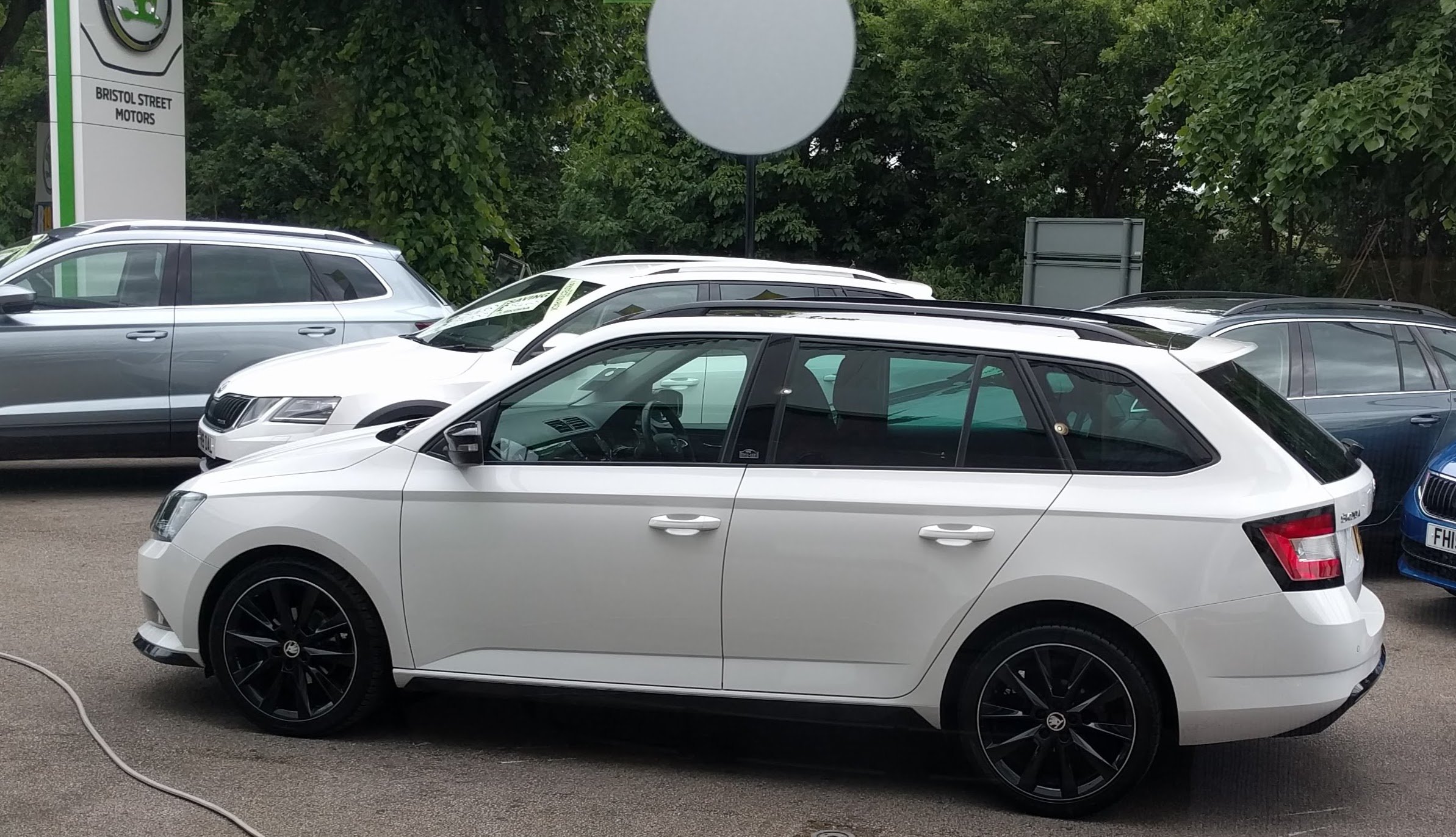

Just got a 2016 Fabia 1.2TSI Monte Carlo Estate with 54k on the clock.  Liking the feel of the car so far, seems to have enough power to be interesting - but not too dangerous for my children who will mainly drive it!
The feel of the clutch worries me though. Feels quite juddery / rough on take off and especially reversing. Is there any adjustment on the clutch itself or does it point to another issue?
